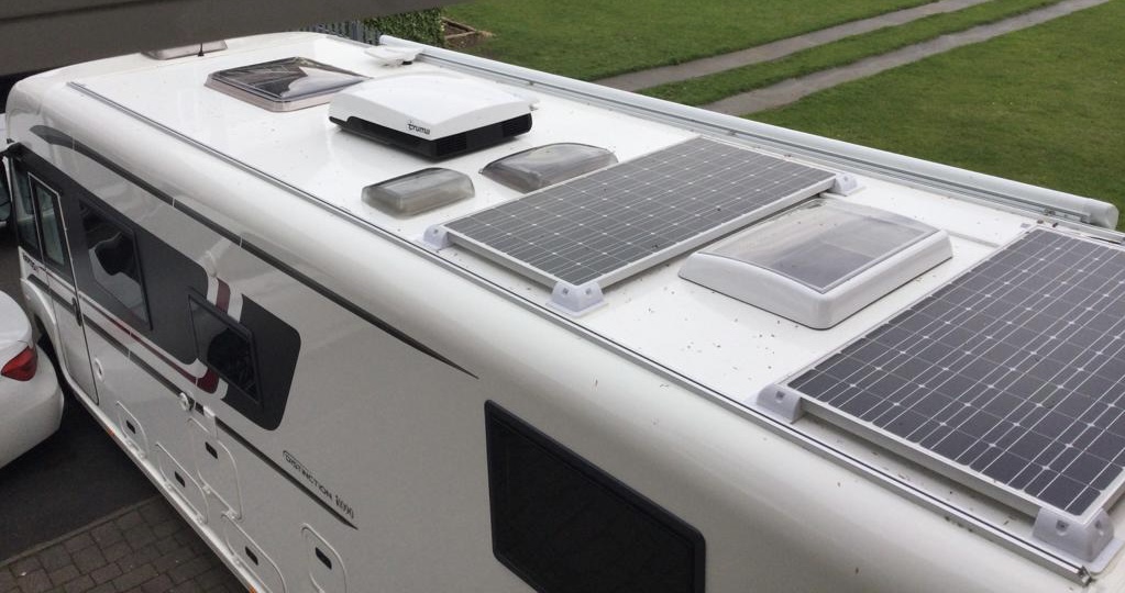

Hi Andy, you are lucky with this van as it already has B2B at the rear of the driver's seat base . Have a look by taking the plastic off. This is the Schaudt WA booster and it allows you to add Lithium or just extra Lead Acid.... Very versatile.
I had a 21 640SLB and I added a second (Varta) lead acid battery next to the NDS battery and I also fitted 150w solar. The Adria is power-hungry as the fridge is 12v all the time but I really like that as it is a great fridge.
If you camp in cloudy weather (UK🤭) mainly, I would get a pair of big lead acids or, if you can afford it, a big lithium as you already have the B2B under the seat ... and I would double up on solar. Then it really makes the Twin the perfect camper IMHO.
I always felt nervous in cloudy weather with just the one battery and no solar.
