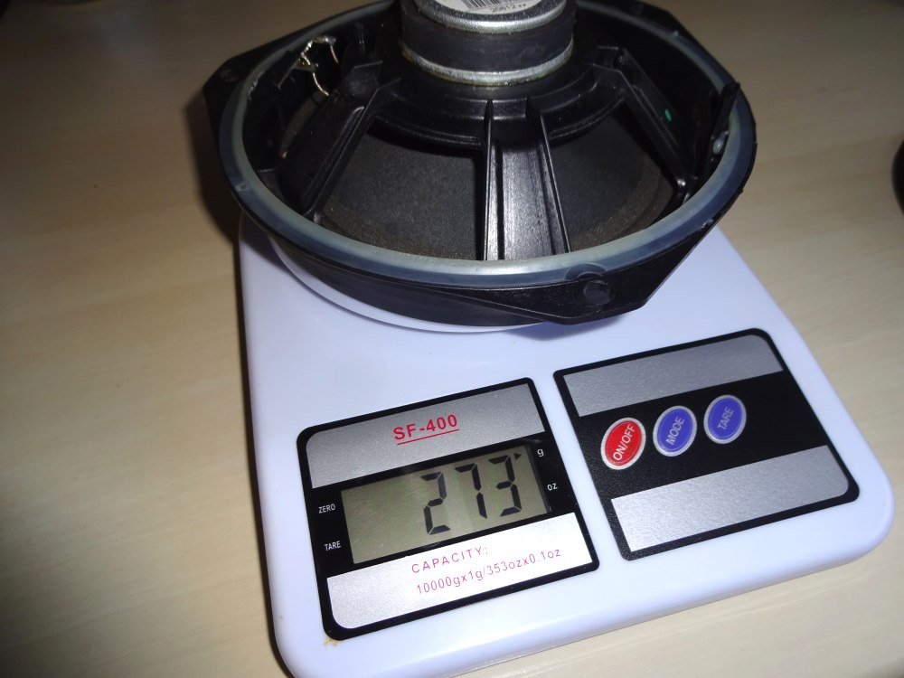

Fitted a pair JBL door speakers along with sticky backed foil/closed cell neoprene sound deadening/insulation material to the inner side of the cab door skins to stop them drumming.
Look at the difference in weight between the original Peugeot speakers and the JBL's. :eek:
