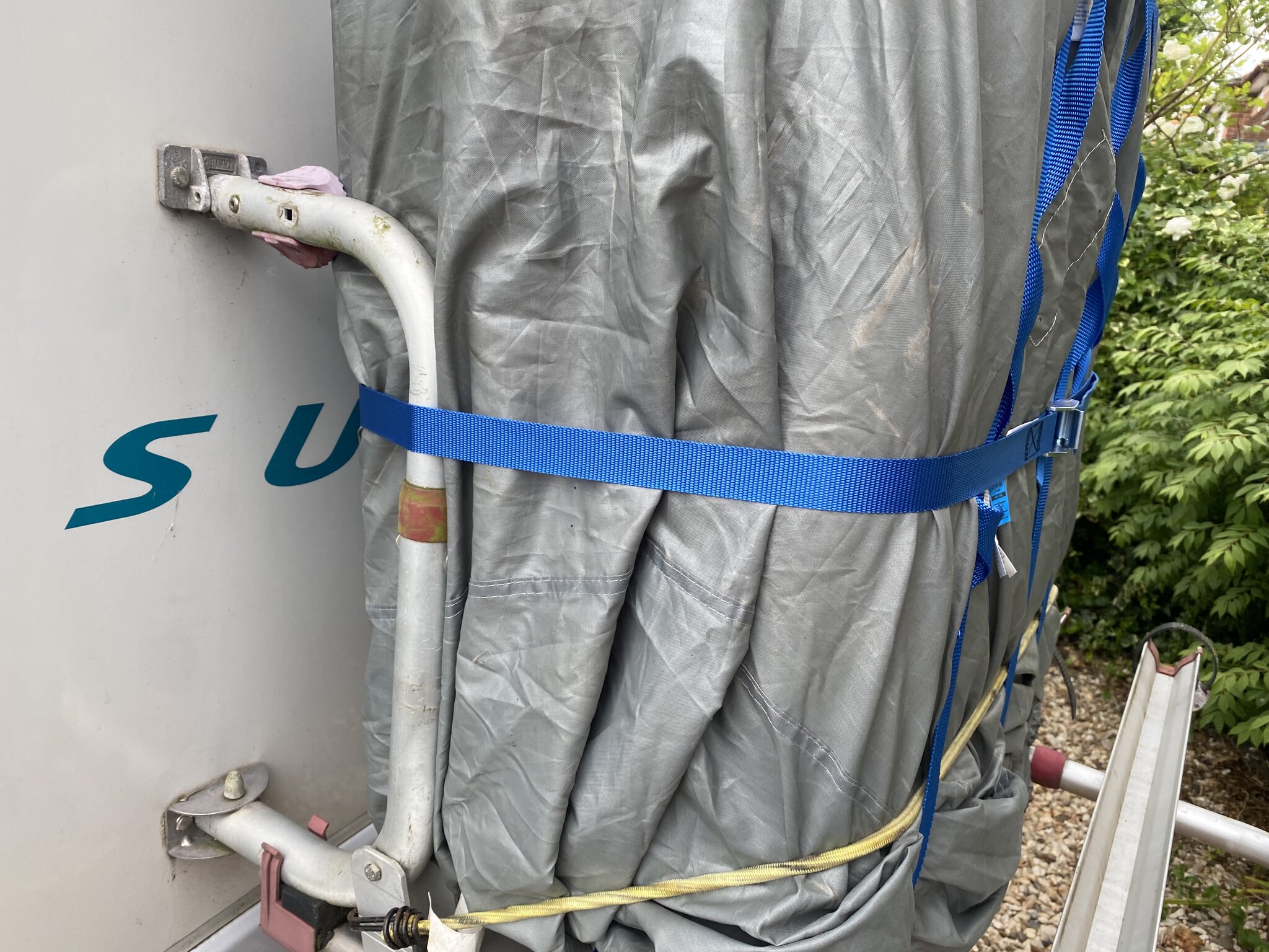

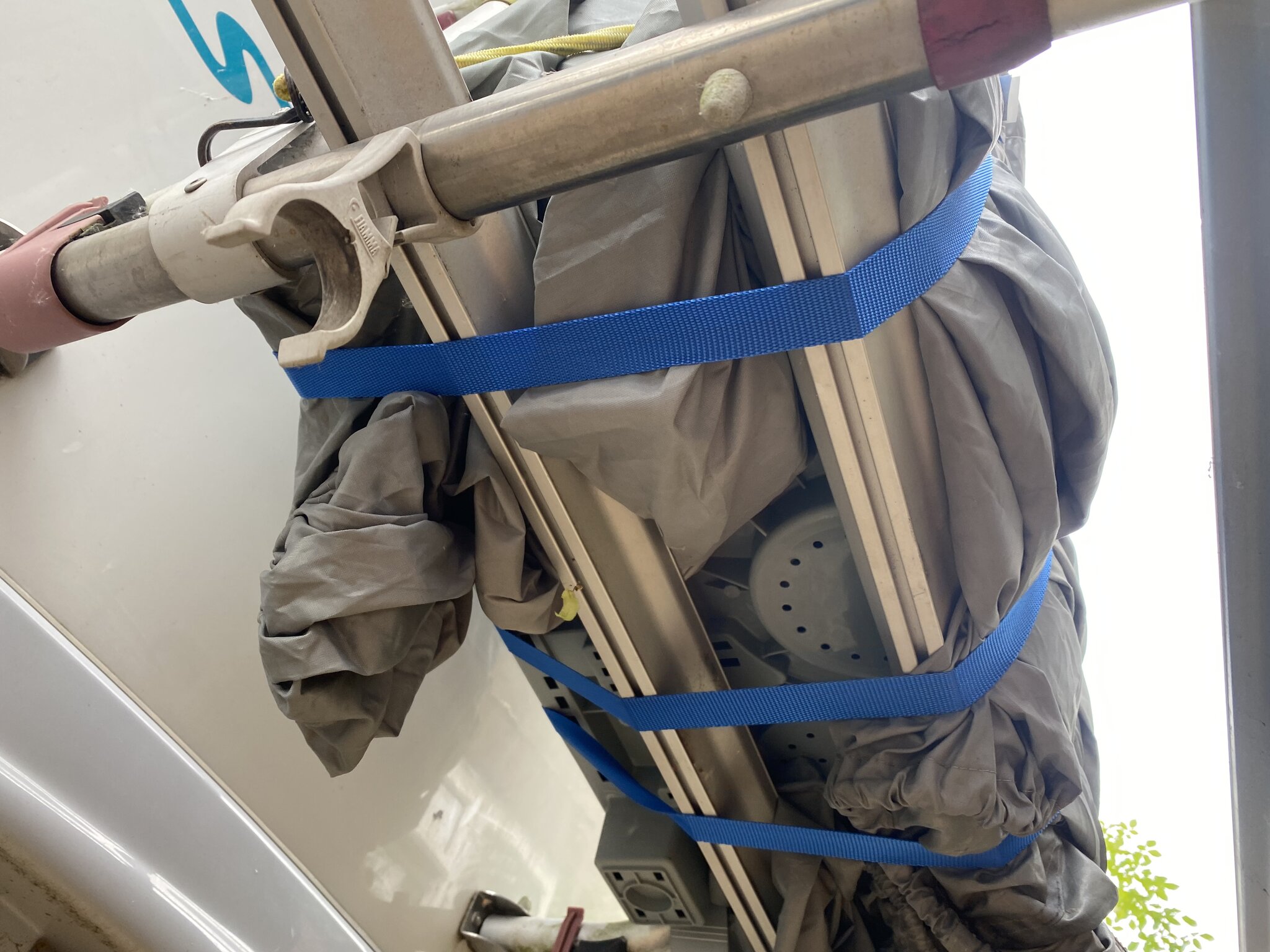

Portable washing machine . Total weight is 12.5kg . It “ wedges “ nicely between the two bike rack bars . Obviously I would ratchet strap it down . Would this be safe ?

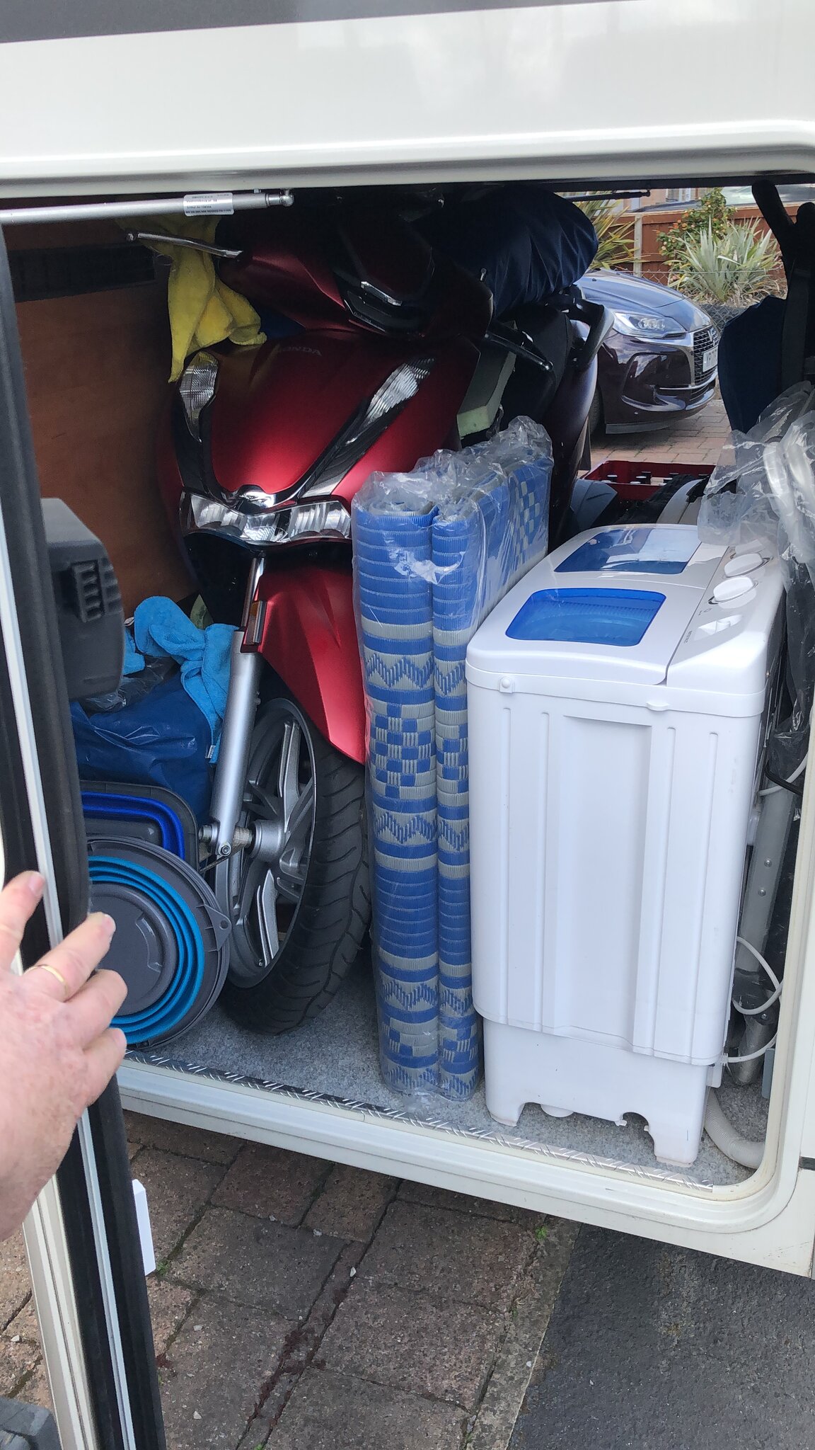

Cheers Lenny HB . It’s the same as the one you have . Her indoors won’t allow me to pay for laundry fees, since we are already paying for sites with EHU . So she bought me this . It’s completely impractical really with no garage but I am backed into a corner 😂. How do you find it to use ? Any good ?
Easy apart from getting it out of the garage with all the other junk around it. Works well only takes 150 watts for both washer & spinner so easy to run off the inverter. As long as you don't overdo the rinsing doesn't use too much water less than ½ a tank about 75 Lt for about 3 or 4 lots of washing, only use it about a third full, struggles if you stuff too much in and no point as the spinner is a smaller capacity but you can fill the spinner right up.
Needs to be sitting "on the bars " not between them:Needs to be supported underneath.
If it "wedges between the bars" then I would screw a piece of ply between the 2 support bars underneath for it to sit on.

It’s sitting on the rack . I’ve tried to secure it as tight as possible with ratchet straps . It seems ok so far , been for a drive and all good .
It’s sitting on the rack . I’ve tried to secure it as tight as possible with ratchet straps . It seems ok so far , been for a drive and all good .View attachment 623736View attachment 623737View attachment 623738
I would put a plate under it as it doesn't have a flat bottom and libel to damage the corner feet like that.
Those are not Ratchet straps those are Camlock straps you will lose it with them, they work loose under vibration.
