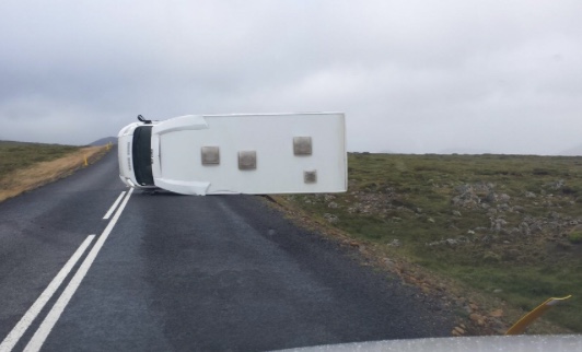

Motorhomes can certainly blow over. A few years ago returning from winter in Spain we travelled along the coast to Portbou at the border with France. A lot of vans parked up in the town but thought nothing of it. As we got to the top of the hill at the border post there were three vans on their sides including a NB Flair. It lifted our PVC onto two wheels and fortunately dropped back onto four. Heart failure just averted although we did lose two headlamp protectors out to sea dropping down into France. Not been that way since.

Being a bit of a geek I checked wind pressures at a couple of windspeeds. At 40mph wind speed it's about 4 lbs per sq ft and at 100mph it's about 25 lbs per sq ft. So a 23ft x 9ft high motorhome would experience a total force of approximately 2 tons applied to its side in a 100mph wind. Of course it would be unlikely that the force would be applied evenly due to the high degree of turbulence close to the ground.
The question of whether this would be sufficient to push a motorhome over, would depend on many other variables which would determine its centre of gravity.

Most likely to happen whilst moving and if you catch a gust in the 'wrong' direction while making a tight turn or correction towards it. Just go careful when moving in a cross-wind.

I wouldn't bet on it I've seen quite a few 7.5t vans on their side and even a44t. Articulated truck all due to high winds.
