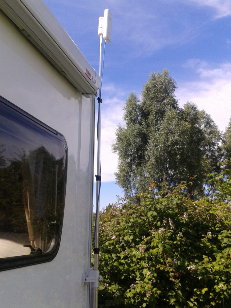

We use a similar system, with the antenna mounted on top of a Status Telescopic Pole and routed through a marine grade usb connector.
We use it quite a lot in France for logging into 'fon' and any other local feed we find.

The brackets for the pole are self adhesive, also the pole is positioned close to a window so it can be rotated from inside the van when searching for connections.
Cheers
Ed
View attachment 105046 View attachment 105047 View attachment 105048
Your WiFi Ariel and lead are identical to mine. At present I have mine attached to the top of a telescopic washing brush handle and simply tie it to my wing mirror with a elastic bungee cord. Very simple and quick to erect. Might look at other options as time goes on. Yours looks OK!
