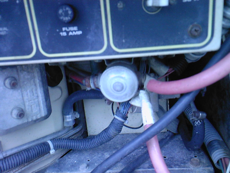

my generator will not turn over it has full battery and half tank of petrol .the round silver thing which i think is the solindoid makes a humming noise and gets warm but no atempt to turn it over..any idears ?

:Cool: Hit it with a Hammer? Or try turning the starter motor with a spanner. I had a starter Motor burn out on our old Coachmen Classic. :Sad:
hi john... i would take a hammer to the starter motor if only i could find it:Blush:
Try shorting the solenoid out by jumping across the terminals to see if the starter motor then turns over. (put a screwdriver blade across but dont touch anything else apart from terminals)
Could be dirty contacts inside it or it is stuck (hammer)

:Cool: Try looking right at the back and towards the bottom. That's if the covers do not completely obscure the view. :Wink:

Jim if you have a manual can you look to see were the starter is for me...ta:thumb:

First of all we need to figure out why the gennie isn't turning over. You said you kept trying to start it. Did it gradually slow down while cranking or was it a sudden failure to turn over? If it's the latter you could have burnt out the master fuse if it has one. You could have burnt out the starter motor or possibly the relay. I don't think it's relay as you can hear it clicking. Putting a multimeter across the large terminals to measure the voltage while someone operates the switch would eliminate those. No voltage possibly the fuse, possibly the relay. Full voltage would prove the relay is ok and point to the starter motor. Low voltage would indicate a battery problem.

hi Doug ..yes it was turning over and then sudden failure thanks for the info with a meter will try in morn. i just wish there was some way to turn it manualy to elimanate jamed starter or siezed up engine. madbluemad has a manual so maybe he can help i tryed to d/load one but could not find my modle

Check all the wires to the solenoid and the starter motor make sure they are not loose or corroded ... if the solenoid is getting warm it's getting power... a jammed starter often makes a clicking sound
hi Tony the problem is i can not see the starter motor has been surgesterd its at the back near bottom.need it for france in two weeks,if all else fails i have a portable one it is a 950 if i plug it into my yellow box would this power the microwave?
