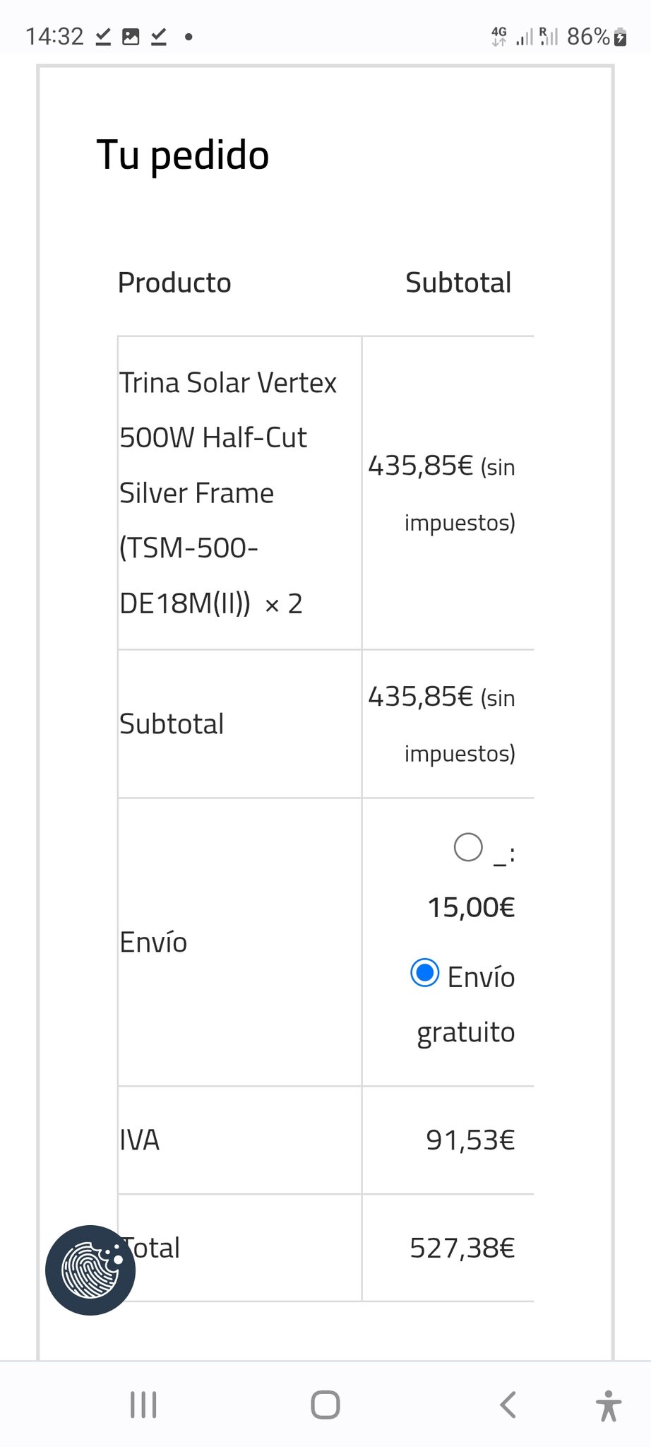

Hi Raul,
Do you think this is a good price for the Trima Vertex? They are 5kg heavier than the first ones I was looking at but they are 510W. I've now got 3 x 200AH Lifepo4 batteries so I'm guessing that these panels will give a higher voltage than the 12v batteries and they will start charging sooner and continue later in the day. Also better for low sun days.
By removing the roof air con, I can get 2.2m x 2.2m, free space.
Am I thinking along the right lines?
