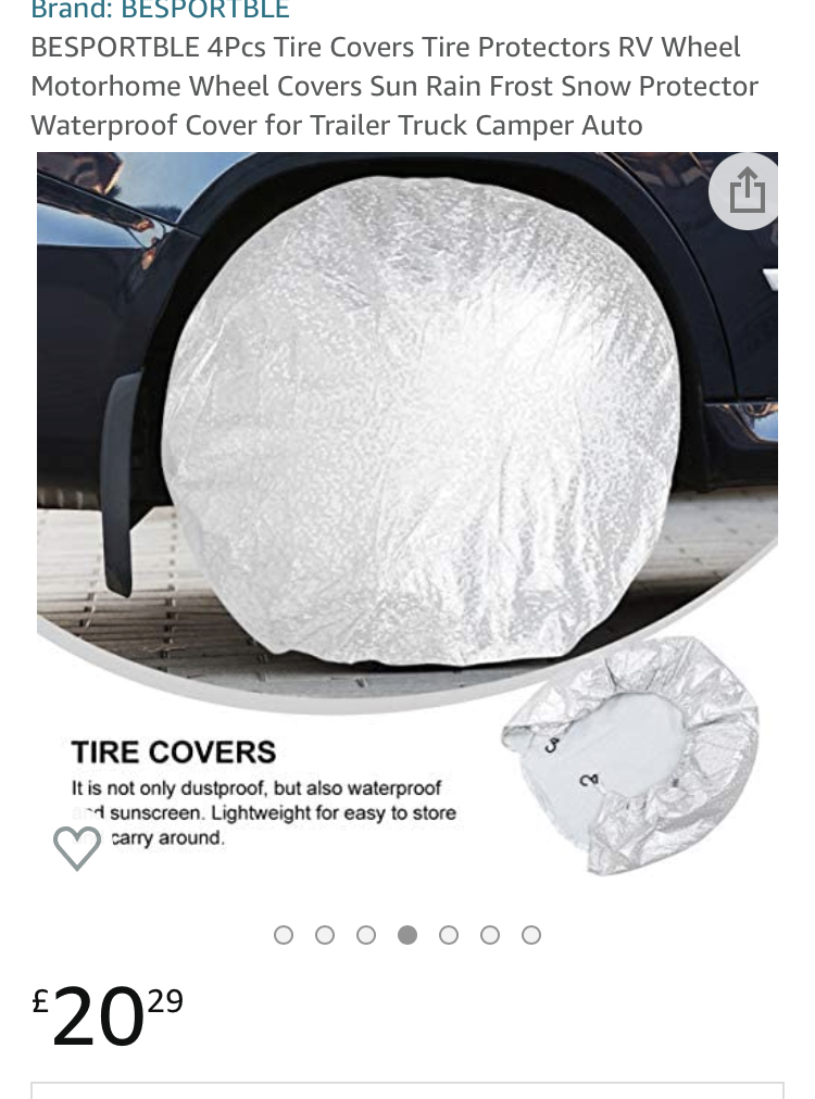

These are very good.
I've used some fabric type covers for a few years, bit of a faf tying the cords around the back which means bending down and getting up again but they do a good job. Currently thinking of shaping some left over exterior ply with a bungee to keep them in place.
Thank you Jezport.
Bailey58 I had thought the same. Adapt with perhaps a belt type strap at the front and then use a bungee cable to insert into the strap and wrap around the cover and tyre. Clip at the front and then rotate from the front until the clip is at the back of the tyre so is not visible.
I bought this type from Amazon but they were nearly half the price
