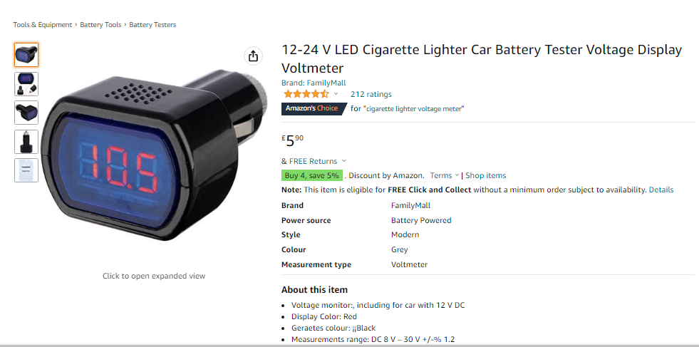

One of the main reasons for a battery to degrade is if it is left discharged, fully or partially, for long periods, say a few weeks. If you are always on EHU on sites and at home, and the previous owners also, then it's quite possible the batteries have kept most of their original capacity, maybe 90% or better. But then again they might have lost a lot of capacity and being on mostly EHU you maybe won't have noticed.
There's no quick simple test for battery capacity, so as has been said, pull out the EHU and switch on a few things, and see how long it lasts. Do you have any way to monitor the voltage of the battery as it discharges? Maybe one of those voltmeters that plugs into a cigarette-lighter socket, if you prefer not to get involved with a multimeter?

Thanks, yes have both a multi meter and cigarette lighter usb reader. What sort of voltage should I let the reading go down to?
I have a cig lighter socket fed by the hab battery and another (original base vehicle fitment) in the cab fed by the starter battery and use one of these to monitor battery state. I also plug it in when driving to monitor the charge rate.
