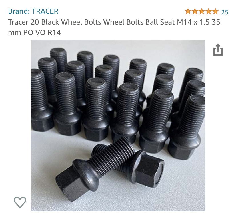

Apologies for not knowing the correct name for parts of the bolts but the thread length of the new black bolt does seem to be the same as the old silver ones however the chamfered "head" of the new black bolts is noticeable narrower. Is this the reason for the slackening off issue ?
See photos for size comparison - the new black bolts do seem to be a bit lost within the recess on the wheel.
Do I just need to buy bolts with an approx 28mm diameter "head" ?

Would anyone be kind enough to provide a link to what I should have so I can compare ?
Do the ones on this photo look any better ?

The originals have a straight taper while the silver in the photo (and possibly the black) have a curved taper so the won't fit.
I'm sure the thread won't cause them to come loose but the extremely short taper could.....less friction surface.

The black wheel retaining bolts do not look correct for the wheels ,but the silver ones do, try the original ones as gus-lopez has suggested and if they are ok and tighten correctly it will confirm that the wrong ones have been supplied. (may be 15" ones?)
