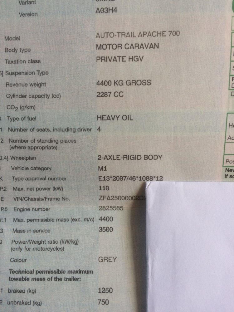

If?, the mass in service weight is 3500kg (a weight bridge will confirm), you have 900kg to play with.
I believe the mass in service allows for a full tank of fuel and a 75kg driver. Everything else added as extras including gas bottles will not be included so use payload.
Only weighing it ready to use with passenger, gas, water if needed etc will tell you how much is left for essentials like wine and beer.
The 5650 is the revised train weight given by Autotrail as the converter. If fully laden, the maximum trailer weight is 1250kg but this can increase providing the MH weight is reduced accordingly.
Sorry edited that as the logbook gives a maximum 1250kg trailer weight it cannot be exceeded

Mass in service would be 3500 kg (usually +/- 5% leaving 900 kg but this is a only rough and should be weighed to get a accurate figure .
