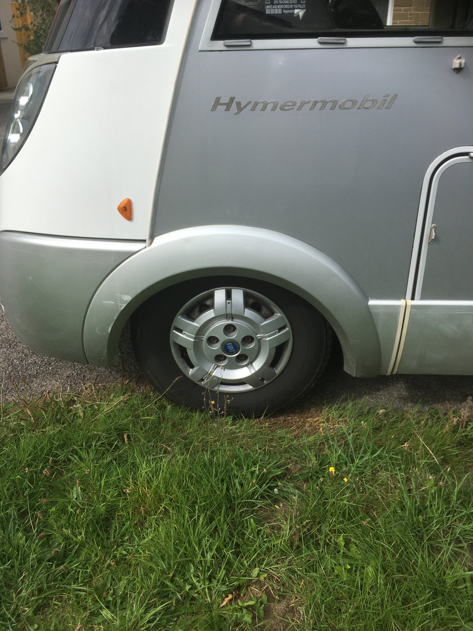

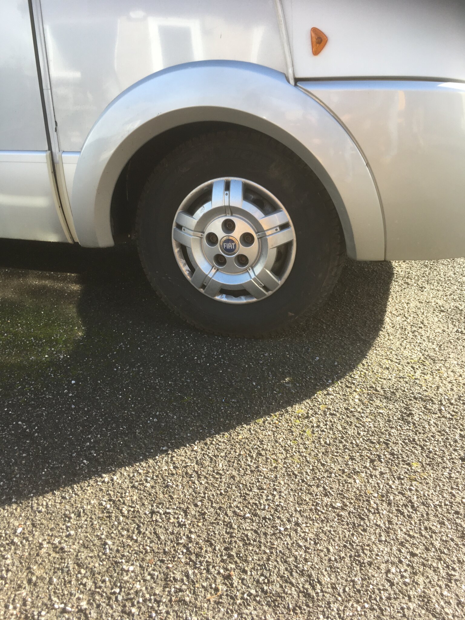

New front coil springs, struts & strut top mounts, on my Hymer B664 ducato X250 based, can’t believe the difference it makes now sits fairly level, hopefully this will make it much more user friendly when setting up level on sites & hopefully won’t knock my teeth out when hitting potholes in the road, the first 2 photos are from before it was done the second 2 are from just now with the new suspension components It’s lifted it nearly 4 inches from the ground.

That 1st photo -on the left - definitely does not look right. I would have thought that the tyre would be hitting the top of the wheel arch when going over a speed-bump.
the suspension had hardly any travel nearly on the bump stops the image is decieving but the top of the tyre is well inside of the wheel arch moulding tho.
