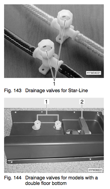

If the drainage valves are open, you are looking for something like the ones shown in the pictures below (although this refers to the 2003-5 vintage). If yours is on a Fiat base, they are probably in the double-floor space as shown in fig 144
