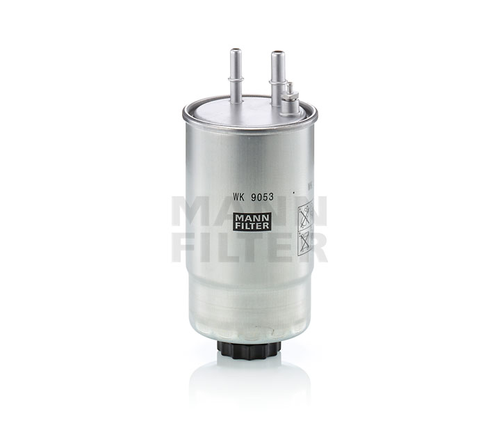

If your fuel filter looks like the one below you only need to slacken the nylon fitting on the bottom approximately 1/2 turn to drain an egg cup full of fuel/water, wear a disposable glove though !
If you find that yours is fitted with the earlier style black plastic filter housing then you'll just need to slacken the drain screw on the side with a screwdriver
Bear in mind that it's possible to have the warning lamp lit due to the well known dashboard fault which is a foc warranty job, even when past the 3 years
