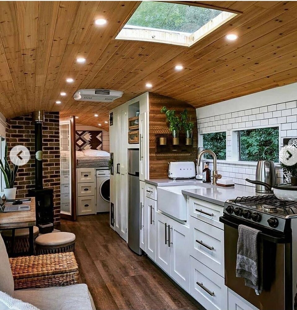

Heres a lovely homebuild with woodburner, and they have a wall mounted boiler with a roof vent .....now i know im possibly in the minority but how homely is that?
Awesome build it even has a washing machine
