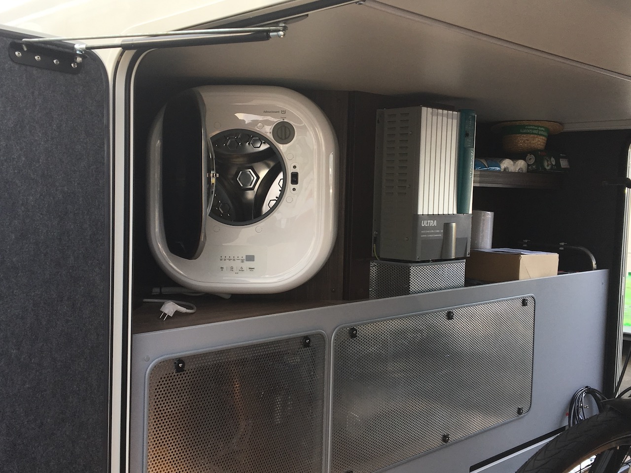

Welcome to fun and congratulations on your purchase, I have seen a few people fitting washing machines in these larger vans with decent payload, for me a full size one would just ruin the garage space so that would be a non starter ;) I have seen these, Just to give an idea of size I have seen these fitted in a gas locker when the van has a tank so the locker space is vacant.
Fitted in the garage of a Palace(y)
We have the exact machine fitted in what was meant to be the gas locker, we don't need the locker as we have a large gas tank. The issue with these machines when installing is they do not have a waste water pump, they are designed to be installed on a wall so rely on gravity to empty. We had ours installed in Germany by a company who have fitted many of them. They install an additional 1L tank low down to allow the machine to empty. The tank is fitted with a level switch and a pump so the tank starts to fill the pump kicks in and pumps the water to the grey waste tank. It uses around 20L of water for a wash. We had ours installed with a bypass valve which allows us to control the inlet water. They are designed like most washing machines to use only cold water for all washes below 90 Degrees (this one uses cold for all washes) So the bypass valve allows us to heat the water in the Alde by using gas then use that water at the inlet which prevents us wasting precious inverter power when using off grid.
It works extremely well and we would not be without it and surprising how much you can get in it. The main concern I would have if fitting myself would be how and where to secure it, it really does create a lot of energy when it goes into spin.
I could add some pictures if anyone is interested in the actual install?
Yes please.
