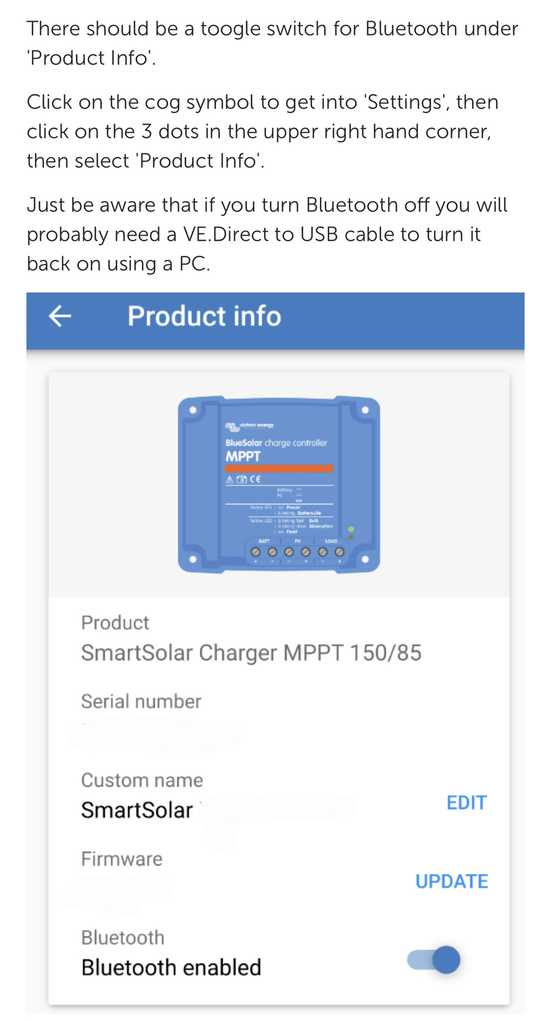

That’s a first of this fault I hear. The way round this, is to borrow a Bluetooth dongle and plug in the VE direct port of the controller. If works that way then the BT built in has failed. Maybe total re boot of the controller could restore function. That can be done by disconnecting the solar and the battery. The re connect the battery and see if is life on BT.
Please be aware if you have accidentally switched Bluetooth off on that device it may need connecting to a PC to turn it back on again.
See the last paragraph on this post from the Victron community forum.

Yes the Bluetooth on one of the solar regulators is not working for some reason
You said that your going on holiday Tuesday, everything is working OK except the App, and now you know how to "check" the output of the panels without needing the Smart Solar App, why not go and enjoy your holiday and contact us on your return and we can either send you a replacement Victron Regulator to swap over, easily done with just for wires into screw terminals or, if you'd prefer make an appointment to come into us and we'll swap the regulator over.
Good point, I'd forgotten that you can switch it off. I assume that the OP would remember if he's turned it off? Mind you some days I don't remember what I did yesterday
That's pretty much what the Victron trouble shooting guide suggests

I switched the Bluetooth off on my smart shunt and came out of the app then couldn't reconnect or see the shunt with Bluetooth, ended up purchasing a VE Direct to usb cable to re enabled it all's well now.
