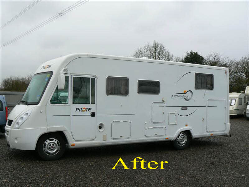

I pride myself in DIY and helping others but I draw a line with this job as it requires garage equipment and it's worth paying for it for the effort alone.
These were fitted for me today by Conrad Anderson and to me they do exactly the same job as the Goldschmitt variety.
These are the heavy comfort springs and having driven the 100 miles plus back from Birmingham I can say I'm happy with Steve Conrads recommendation for these.
Before and after

So there you go Lunarman! Should make a load of difference to yours :Cool:

Looks to have made quite a difference.
How did they reach the bolts on the top of the struts particularly on the drivers side?

I don't know John I had to sit in the waiting room :cry: but from info I've seen on the web they drop the fuse box out.
Also when they stripped my passenger side strut out they discovered it was FUBARED. The damper rod had no resistance at all and the top mount bearing was fragmented. This cleared up an issue I had in France last year where it suddenly started sounding very harsh on that side when steering, the noise disappeared a few hours later so I assumed Id picked up some gravel and it cleared itself. Anyway luckily they had a low mileage strut from a van that had been uprated to air suspension and they were very reasonable on price despite having me over a barrel :ROFLMAO:
Very happy outcome :thumb:

Are you sure they haven't just swapped the wheels for 15" ones :ROFLMAO::ROFLMAO:

Van still slopes to the front but I wont need the top two steps of the quattros anymore :Cool:

After talking to Andy and seeing his report I bit the bullet and had VB comfort springs fitted to my van. It was always nose down (could not driv onto my milenco ramps) and the front suspension was non existent. Even the smallest pothole created a bone shattering jolt.
Being 3.0L and A class with the additional weight of the bed in the front I don't think the standard springs were man enough for the job.
The new springs have lifted the front by 2.5" at the wheel arch so there is now some travel in the dampers. When they took the drivers side strut off they found that the original spring was put on upside down so it did not seat properly in the bearing cup.
On the drive back it was a completely different van much smoother and I could hardly feel the ruts in the raised section of the M5 at Birmingham. Also the steering is better and the van does not dip at the front corner on roundabouts.
All in all very pleased.

Early last year at Brid CC facing uphill but still second step on the quatros
Yesterday between storms, now looks like a 3500kg van
