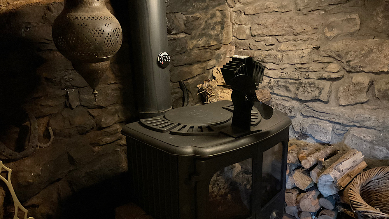

Charnwood have a cooking plate that sits in the vent that exits the top (you have to have rear exiting flue fitted…) 2 sizes depending on hole. I fitted one for our morso wood burner with a bit of adjustment with an angle grinder to the plate…
the plate gets much hotter than just the top of the stove did, haven’t tried it yet for cooking but should be ok if wanted for slow simmer of a stew or similar. Noticed that it has ‘calmed down’ the air flow a little when fully open when lighting which probably isn’t a bad thing as it roared like a jet engine if you let it before.

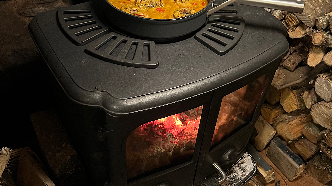

Just tried out the new cooking plate on the wood burner.
the fire isn’t roaring as you can see, back flue temp is actually quite low at just over 100 deg c. Put a cold pan saute pan on top with yesterday’s pre-made Thai curry, had a read of a few web entries and could smell loveliness!! It’s simmering away nicely. If I had the heat up further, it would probably be too much!!
rather impressed! Will get the water For rice heated up in the kitchen and immediately bring it in to cook. The movable little trivets will keep the curry warm…

They come in two sizes, I think for 5 and 6 inch hole and they also come with kit for fitting With rope etc.Theres two ways of fitting included, either a backing ring that you screw into the plate so it clamps to the burner hole or you can screw a couple of lugs into the plate that clamp onto the inside of the hole. I used an angle grinder just to take a bit of edge off the bit of the plate that fit’s in the hole so it would fit correctly.
On the website, if you have a Charnwood burner already, it gives what size you need for which burner. Obviously mating it with my Morso burner, there was no guarantee!
