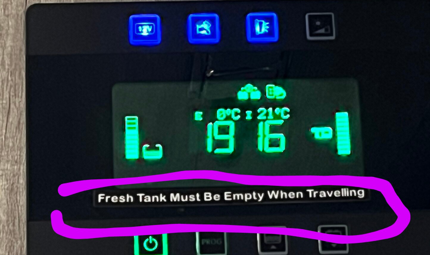

Just starting to dip below zero here at Burrs Country Park CAMC site, van is a nice toasty 21 degrees and that’s with the internal door to the boot open to let some heat through! Our Wildax Elara panel van copes with Uk temperatures easily, never been winter skiing in it though …
What's that all about, it makes the van unuseable.
