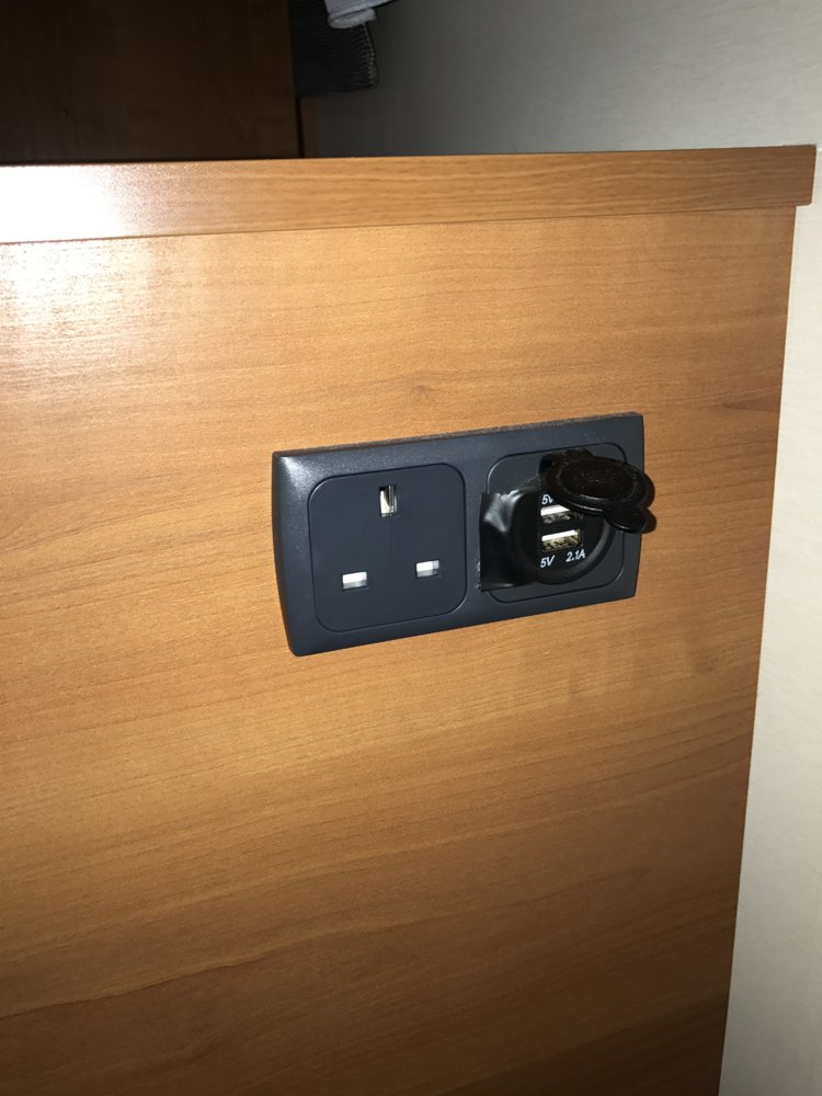

I have fitted a 240v C line socket and a twin USB to the bedside cabinet on either side of our Rapido. The scary bit was drilling the 35mm hole through the timber! The rear of the cabinet gives access to the underbed garage which gives access to the 240v and 12v (Leisure) fuse boxes. I have connected the 2 x 240v sockets into the ring main, and of course that is live when hooked up to the EHU. We plug twin USB adaptors into these to charge phones and tablets when on EHU. The twin USB C line sockets are on switched fused circuits from the 12V Leisure batteries and are "always on" when required. We use these for a USB digital clock on my side and to charge phones and tablets when not on EHU. Note the black tape! This is because I bought sockets with permanent blue LED, which unfortunately performs well as a night light, so I cover it with tape. I should have bought Ines with no LED. Note there is a drain on the USB sockets even when not being used, but fortunately the leisure batteries are trickle charged by solar panels in the roof.

View attachment 180099 I have fitted a 240v C line socket and a twin USB to the bedside cabinet on either side of our Rapido.
Hi there - this is EXACTLY what I'd love to do in mine. The two bedside "tables" lead straight down into the garage. In the garage I believe there is access to the leisure batteries but will need to go have a look. There should be 240v in there too but once again I'll need to check.
There is absolutely no way I'm going to do that work myself. I am a completely useless handyman so I'll need to get someone to do the install for me.
I too have the solar panel fitted and will make sure that whatever I have fitted does not have the LED light on it. That would drive me nuts.
Thanks so much for your post. It has helped a great deal.
