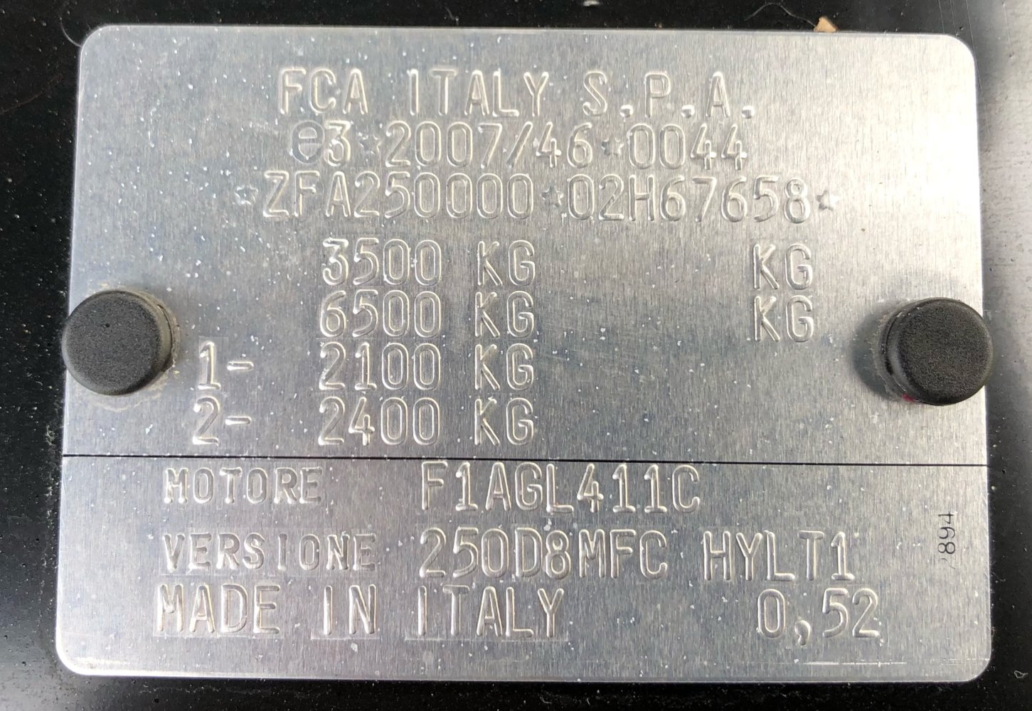

@Grianan - do your VIN plates show the same as mine?
Hi @Minxy Girl
Yes my plates show the same as yours.
However, I’ve just checked and SVTech uprated us to 3900kg; we had requested 3950kg which they said wasn’t possible.
If I am going back to SV Tech to query this (which we did at time as I had asked for more) it would be useful to have a definitive source for the maximum uprated rate. Do you know where I can find that?
We’ve already paid SVTech £312 so I’d like to persuade them to do it for free!

Our engine is 2.3 150 BHP
I’m not understanding that table. It seems to tell you what it is supplied as, rather than what you can uprate it to.
In theory the maximum value should be Axle 1 + Axle 2 (ie 4500kg) but there might be a safety coefficient applied to allow for cargo shifting when braking.

If you look at the table you can see the figures 4000/4250kg next to the LXH2 version of the Ducato Maxi which is what the Globecar Campscout is built on, either the 40 or 42 version depending on the engine, so all are rated at 4000/4250kg by Fiat.
I suspect SVTech are using the wrong info for your vehicle and 'assuming' its on the Maxi 35 chassis and not the Maxi 40 chassis so I suggest you get back in touch with them and ask them to tell you why they are restricting you to 3850kg (which is the maximum for the LXH2 35 chassis) instead of 4250kg, letting them see the Fiat info/table.
It is the converter who just puts them out at 3500kg to encourage those with a 'restricted' licence (ie 1997 onwards) to buy them, rather than putting them out at the higher rate and reducing their buying 'pool' to those of us with pre-1997 licences which allow us to go higher. If you look at your Certificate of Conformity it will show that the axle weights are unchanged, ie 2100kg front and 2400kg rear.
If there was an issue with this then when I asked for my current camper to be first registered at 4250kg it would have been refused, and when I uprated our previous one it would also have 'failed' too.
