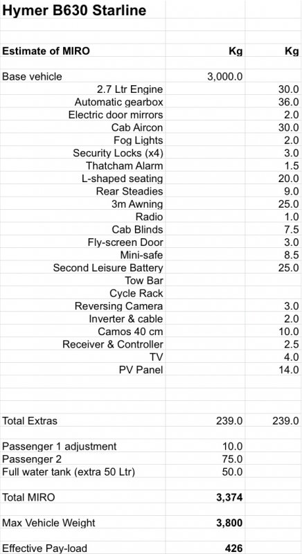

I have a 2003 B630 Star-Line on a 316 Sprinter chassis. It is slightly shorter than your B655 (I think that is what you have as there isn't a B644 Star-Line). The MIRO will depend on the chassis, engine and gearbox plus any additional fittings. The Hymer 'book' figure for a B630 MIRO is 3,000 kg (yours will be a bit higher - say 3,050 kg). But that is for a van based on 313 Sprinter chassis with manual gearbox and no extras. The 31x chassis has a GVW of 3.8 tonnes.
If yours is on a 41x chassis, the MIRO will be higher still, but then so will the GVW - 4.6 tonnes (unless it's been down-rated).
As an indication of what else to take into account, I have shown below the calculations I have used, as advised in the Hymer model catalogue and from known weight data.
Hello there JeanLUC, Sorry,my mistake mine is the 655 starline,don't know what I was thinking of there,the base is the mercedes 316cdi. but as I said in an earlier email it does not show the unladen weight,or MIRO as it has now become known,I keep harking back to my caravanning days of years ago,the VIN plate does state 3800 as you say,but it's a pity that the manufacturer is not legally obliged to include the MIRO if they did I think as consumers we'd have more of a level playing field, thanks for your help and interest,gwyntaxi.

I understand your frustration but in defence of Hymer, they quote the standard MIRO in the model catalogue - not handbook (or used to). The problem is that this can only be a starting point as so many options exist and dealers can fit extras after the van has left the factory but before it is sold. That is before even considering what may be added prior to a second-hand sale. My chart above gives an idea of how this can change the MIRO, in my case increasing it by 239 kg.
The only way to be certain is to fill the van with water, fuel and lpg; add essentials that you always carry, then go to a weighbridge. Take the result away from the GVW of 3.8 tonnes and you will have the available payload.
In practice, I have done it the other way around by loading everything we want to take for a decent trip (say 4 or 6 weeks) including food, clothes, bikes, toolkit etc., full tanks of diesel, water and lpg, then I have gone to the local weighbridge with both of us onboard to check things before departure - leaving enough time to go home and make adjustments if required.
I have done this twice in the last two years: the first time we had about 100kg spare, the second time we had about 80kg spare. At the same time I check both axle loadings by having the whole van weighed, then just the rear axle (the front axle load is found by difference). I have found that there is plenty of spare on the back but the front has less; surprising really considering it's a RWD chassis, but then the 2.7 engine and auto gearbox will add a bit to the front.
