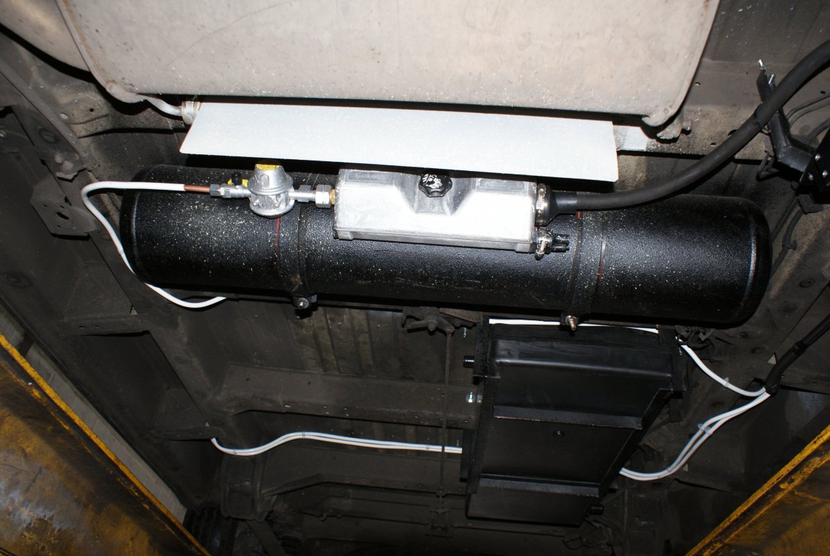

Purely for clarity and balance not all professionally tanks are "crap" jobs, here's one I prepared earlier:

Easy to do for yourself Andy but when doing it for a paying customer time is an issue so no extra coats of paint prior to installation and that "black messy stuff" is rubberised stonechip paint, not just underseal so provides a good barrier to the plastic coating getting chipped. Our supplier (Autogas 2000) ships the tanks well wrapped and protected against paint/coating damage. I also fit a metal heatshield/physical barrier in front of the tank which is right behind the exhaust silencer (hence the heatshield).

Nice Job Dave but I notice it is strapped in rather than a cradle, I understood straps alone were no longer legal, have I been misinformed.
To OP do check your payload before having it fitted.
Hi Roger, there are no legal requirements in fact. But they are not "straps" as such, they are in fact 4mm thick rolled flat bar shaped to go round the tank and are part of brackets fabricated by Autogas 2000 to mount tanks on Ducato/Boxer/Relay chassis, the brackets are bolted through the chassis cross members in front and behind the tank with 10mm bolts in crush tubes. This mounting is in full accord with the NCC/LPGUK code of practice.
