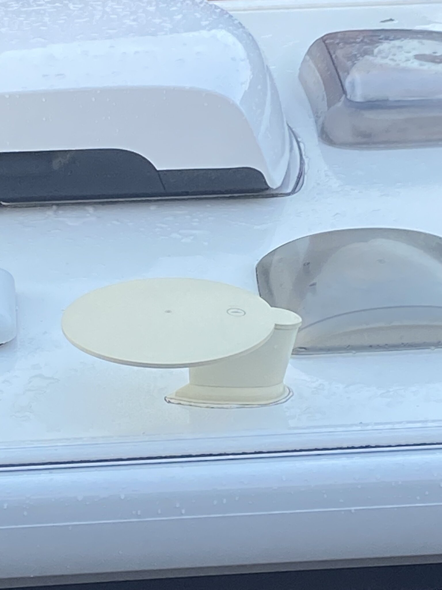

Hi everyone. We have recently returned from a long trip around Scotland. Whilst I respect things are remote we really struggled to get TV reception. Everywhere we went we had to auto retune and on all but one occasion we found no stations and we just gave up. However, I then noticed others had reception. It puzzled me so hence my question. I am interested to know if something is wrong, we are doing something wrong or whether the aerial we have is just not good enough. We have a burstner harmony line 720 2019 model. As an aside when we got home I tested it and all tuned in fine. I am keen to know experience of others and if we need to change our aerial what would be recommended. Picture of the aerial is below. Thanks in advance for any help.
Do you also have an aerial amplifier inside the van. Without this then reception with that aerial is poor. With an amplifier it's very good.

It's the same aerial as we have and we get good reception in most places. You have to retune every time you change the reception area but that's not a huge problem. Scotland probably has quite a few tv reception cold spots so it's either mobile data if available or satellite if you really want to blow the budget.

Just to clarify: omni directional aerials pick up around a full 360 degrees, so don't need to be pointed at the transmitter.
If you look here https://ukfree.tv/maps/freeview you'll see Scotland isn't over blessed with transmitter sites, and with your antenna mounted around 3m off the ground rather than on a tall roof top pole, the chances of seeing a site are very much reduced.

Omnidirectional aerials seem fine now we're digital. You often had ghosting on analogue signals in the past. Invariably whenever you move more than a few miles retuning will be necessary.

Scrap that waste of roof space, it's omni-directional and will always be crap reception unless you parks next to a TV mast.
A directional aerial such as the Status 570 is far superior.

Hi andy. That's a Maxview Gazelle antenna, but the booster doesn't sound familiar. If you could get a photo I can take a look at the spec to see if it's on par with our normal booster.
Unfortunately there will always be areas where you can't get Terrestrial TV coverage, especially up in Scotland, but on the whole, omnidirectional antennas offer a good compromise between performance, size, cost and ease of use.
