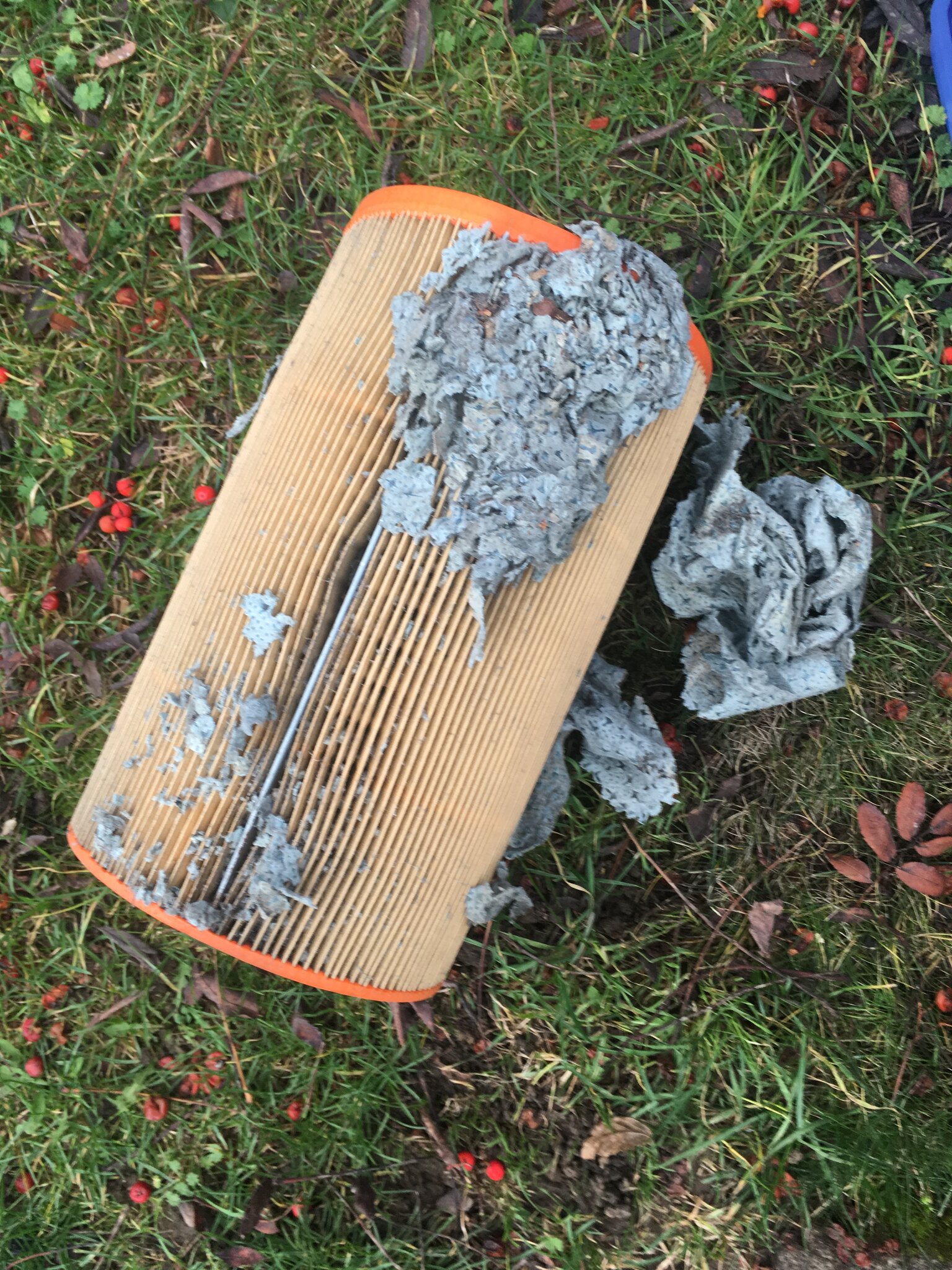

Check your air filter. I’ve know people to put rag (and other items) on slam panels of vehicles whilst working on them, and with Ducato’s it is the air intake, and people don’t know this.
And this can happen

Landy Andy spot on although not a cloth. We had mice over winter and it looks like they ate some of the bonnet lagging then stashed their leavings in the air filter. 🐭
Easy fix then.. 👍🏻

Jane And Rog - it would be good to complete this topic and post about the cause of your problem and fix in this thread (as well as the travel one) so if anyone is searching in the future, they get to see the complete route cause was indeed boost loss, not just the mice! 👍🏻
Very true. So it looks like there are two problems causing this, maybe three. I don’t really know if we can define any as the root cause. Still, the problems were:
  • very sooty engine, including the boost pressure sensor due to:
  • partially blocked air filter caused by mice eating insulation and
  • pressure loss from a cracked (intake) host due to the prang.
I’d like to say “if you see this problem, check for cracked/loose hoses and change your air filter” but I think that wouldn’t have cleared the fault in my case because of the soot which I think was caused by 1000s of miles through the uk and France with the mice ridden filter. It’s certainly a good start though.
