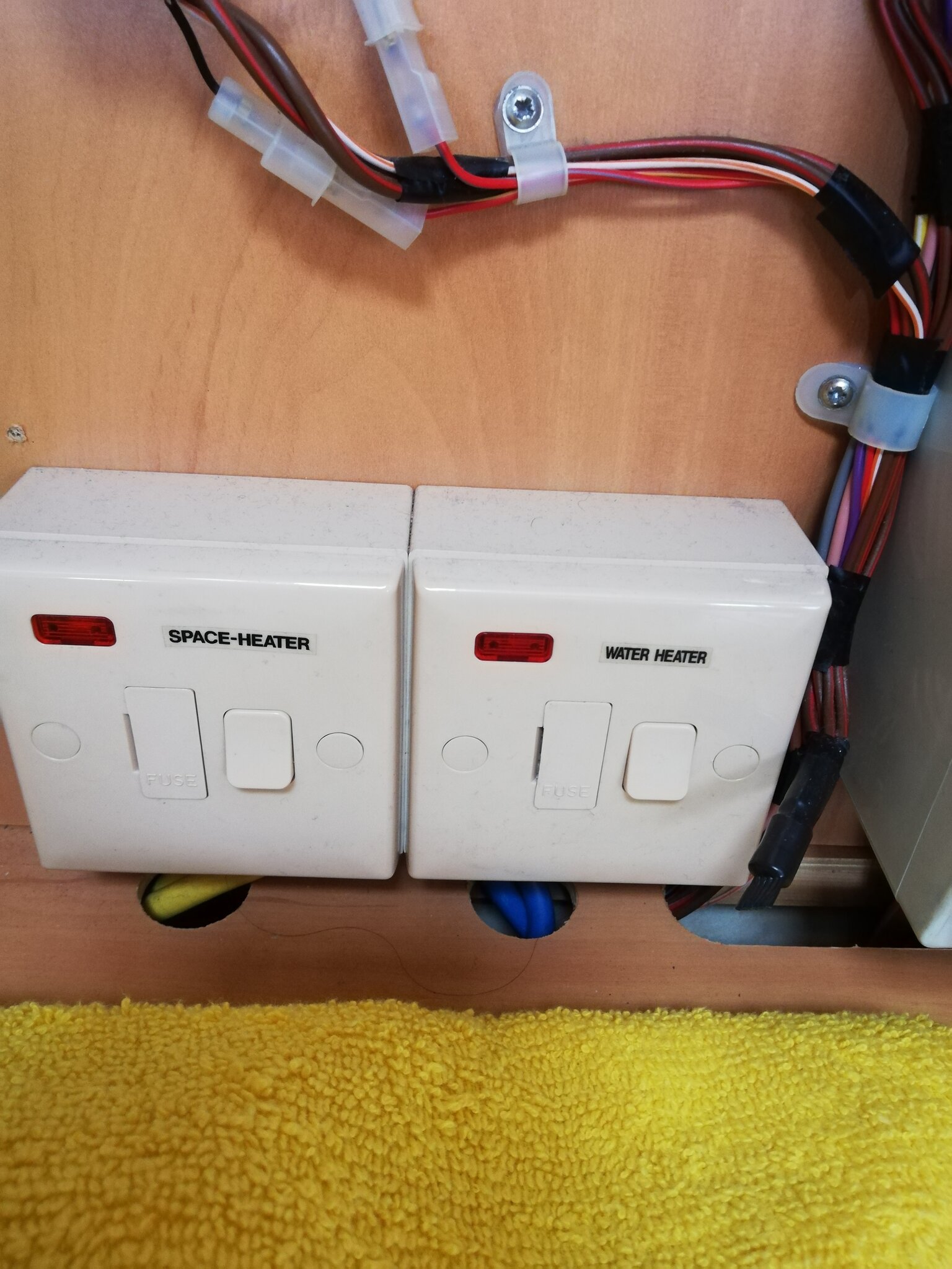

These are my controls
Above are the switches to power my heating and hot water from electric when on EHU.
Above are my Truma controls, right gas left electric.
This is my fire which I have to ignite to have my heating on gas.
Does any of this look familiar ?

hi guys, drove over to the storage unit tonight and took these photos of the truman heater etc
sweet caroline can you post up a picture of your Truma controller/controllers as that will show us what is running your heating and hot water.
View attachment 718643 View attachment 718644
The top switch left hand side red up and down, is large flame and small flame, so realise that is the fan strength, large is quick heating, and bottom flame is a steady flow of heating. The red switch on the top right. is O for OFF, and up for heating, on, and if i switch it to the bottom, only cold air comes out ? bottom switch ive never touched ? as not too sure what that is for? hope this helps the experts out there hahah

I think the bottom switch in first photo could be a 240volt heat element.
But I could be wrong 😊

Yes for the water.
great stuff thanks. but as for the heating? does it work from gas or the EHU? back to if there is NO GAS SHOWING on this very expensive gauge, how does the heating work ?Just im slightly well alot CONFUSED really hahah. Not changed the bottle, and it is still showing RED ! haha
