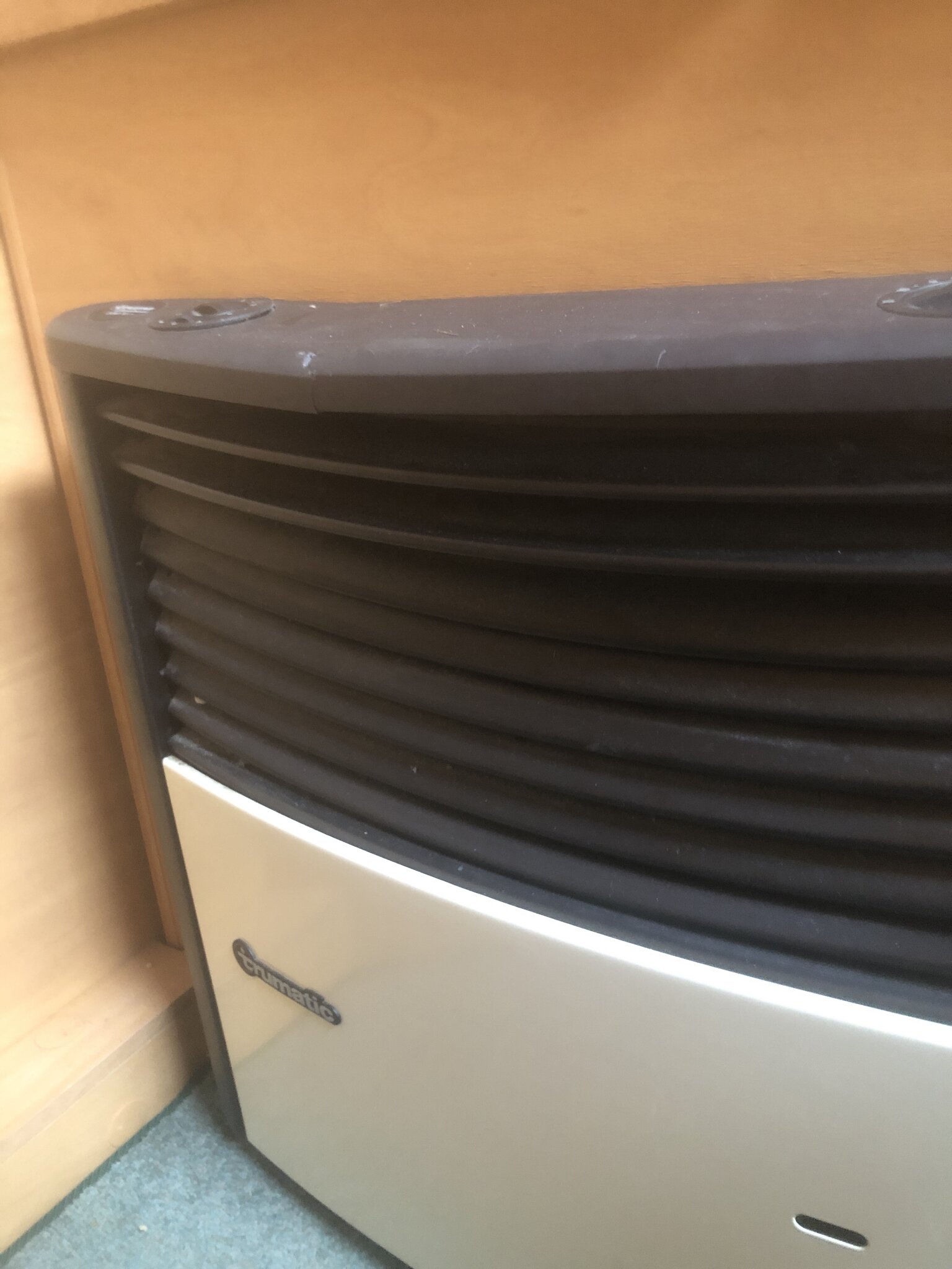

Hello, ive got a truma fire/heater it came on and worked fine then its stopped working just blows out cold air,works fine on gas,i can hear a click when i turn it on by the stats on the wall, is there a reset or element gone any help would be great,i am a qualifyed gas engineer so can work on these.

Here You go the van is 2004

Does the red light on the “space heater switch “ illuminate when you switch it on ?

On the thermostat do u mean there’s a green light, no lights on heater there isn’t one

The main power switch for the heater . Should be in the wardrobe behind the heater. Is this switched on ?They do the a while to get warm once you switch in on . It’s not instant heat like a portable heater .

They have an element behind the heater

Think the battery is for the ignition
You are correct. (y)
Has the RCB tripped? If no RCB for that circuit, might there be a fuse? I don't remember any lights on ours either, when we had one in our caravan.
Ours had a double heat setting on a cream coloured wall switch, ie, 1Kw & 2Kw ............. or similar outputs.
Good luck sorting it out. (y)
