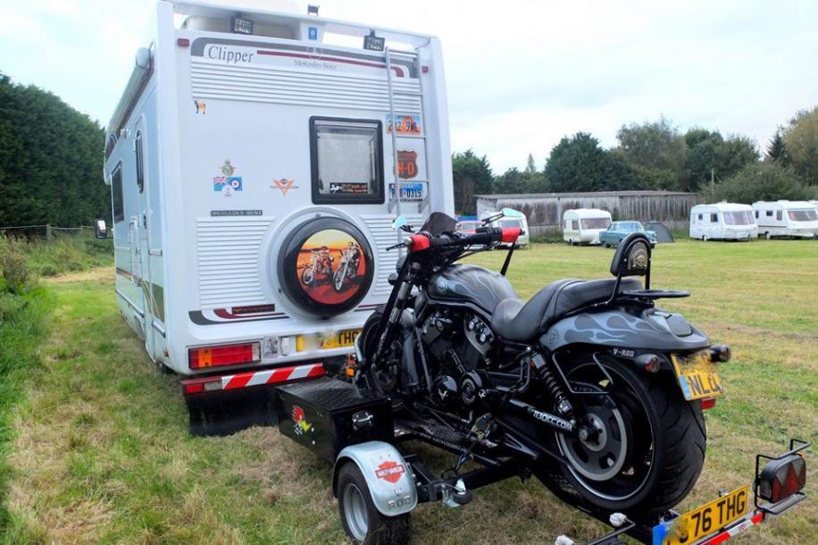

I use one of these,flat loading and folds in half for storage,you can stand it up on its side at the back of your garage if you have one,pic with my HD and one with my Triumph.
