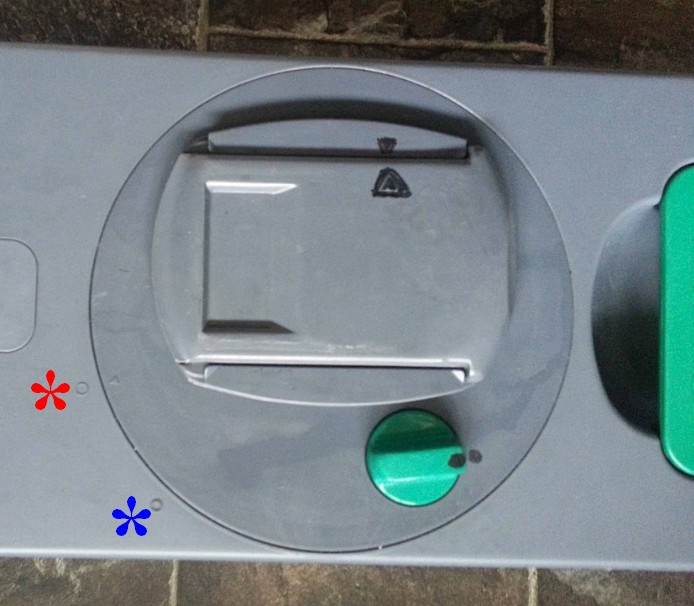

The center of the toilet cassette shown in the pic looks like it should rotate and come out for maintenance? is that the case as mine doesn't won't to rotate. It may just need a bit more force but I thought I'd consult the forum first. The mechanism has got stiff and I think the seals may need replacing. Presumably this stuffs all available? Any advice appreciated.

Don't think it does rotate. Never tried but....
Google thetford cassette parts diagram which should give some idea of the construction

It doesn't rotate. As you are probably aware, the centre cover slides out to reveal the seal and the disc which is opened when the toilet is in use. The disc can be opened by twisting the green knob.
When the cover is removed there may be some screws visible depending on model. The two bars either side of the cover pull off and reveal more screws. Removing the screws allows the seal to be removed (and also gives access for more thorough cleaning).
Thetford sell special stuff for cleaning/lubricating the seal but olive oil is as good in my experience (not sunflower or vegetable oil or other lubricants). You may find the seal has hardened but replacing it (check eBay, much cheaper than the full kit) is easy. The original can then be rubbed with olive oil and may recover its suppleness enough to be used as a spare.

Yep it just rotates, if you open the flap you can put your hand in to get a bit more pressure it is quite stiff.
Take a note of which way it was fitted as it can be fitted the opposite way round, this is for for LH or RH fitting.

It does rotate the older ones had screw fitting no screws on the newer ones.
It does move.
If you look alongside the Red marker on the picture you can see an 'arrow' indentation.
Move the Red marker anti clockwise towards the Blue marker and then you can lift it off and access the interior.
It is usually stiff to move, it's supposed to be a tight fit, but if you slide the lid across it's easier to get a grip and move it round.

Thanks to all who have replied, I put a little more force on and it rotated out easily, as you can see from the photo. Its now very easy to clean and lub the seals with with the Thetford spray which I do have. I like the olive oil advice though. Many thanks for your help guys.
