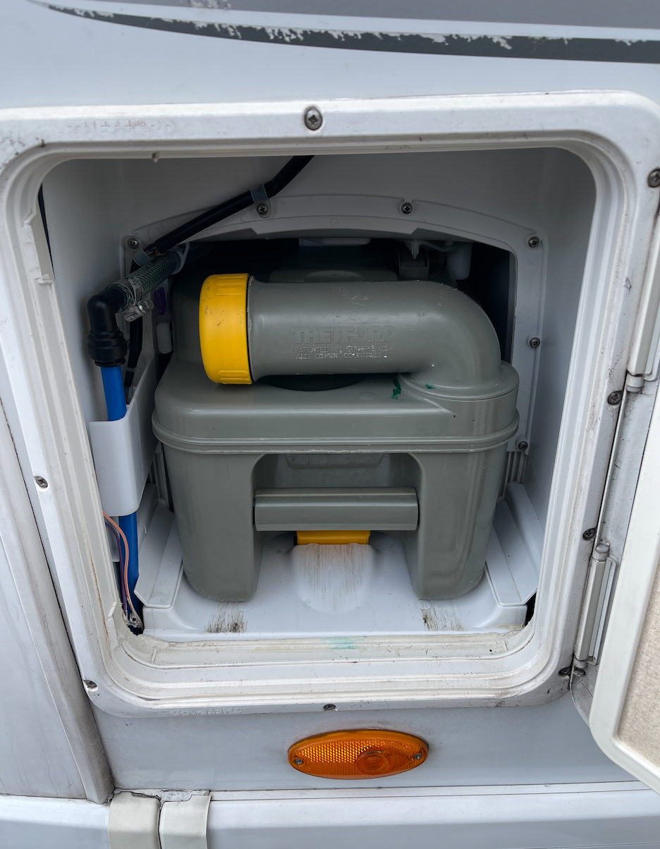

just bought 2 new wheeled cassettes for my 05 rapido and the do not fit will not lock in with the yellow clip it seems to need another quater of an inch. but when i try to push it further in it it meets some resistance but cannot see what. any one had this happen any ideas thanks

Just double-check that the vent fitting on the top of the cassette (near the handle end, but not the one you press when emptying) doesn't need changing. The new ones have a fitting that sticks up to match a rubber bellows on the newer toilets. The old ones just had a flat button that was pressed open as the cassette slid into position. It may be this that is stopping the cassette going all the way in. AFAIK it should be possible to swap them over between cassettes to suit your toilet.

only loose 1/2 litre in voloume it is for a back problem that changed Pete . thanks Misterg the air vent is a little longer so a quarter turn sorted it. panic over noni

Just to revive this thread. I have a C200 unit with no wheels. I want a new one but as above they all have wheels now. I am confused if for some people it went straight in and the OP said he had to change the vent over? If so where do I buy the vent?

I bought a new C200 cassette with wheels, fitted perfectly, no mods needed. It could be some people have an extra vent system, such as SOG, so there will be an extra vent pipe. I got the new cassette as the old one started to have problems with the flap jamming. I intend to deep clean and refurbish the old one as a spare if off site for more than a few days. Considering some kind of rack so I can store it under the floor. We have the 2001 Alko chassis.

Me thinks its the orange pull along handle thats causing the problem
It not only got to go back in its got to be IN IN ie locked behind the grey tabs
You can get a false in that makes it slightly too long 1/4 of an inch or so

Hi I just splashed out £135 for a new C200 cassette with wheels for a 2016 Hobby and didn’t fit properly, about a cm short. The grey vent valve is different on the new cassette. Thanks to the suggestions in this excellent thread, I changed the valve from the old cassette to the new and now all is fine 😃. Dead easy as well, just twist to 45 degrees and the whole valve lifts out.

Hi Noni, had similar problem, turn the vent valve to 45 deg and pull out the valve and put it back but 180 deg offering ie upside down, then the casette was able to fit

Actually my previous message incorrect! I ended up taking out the vent valve on the new unit, turning it thro 180 deg and replacing it back into place, then worked fine
