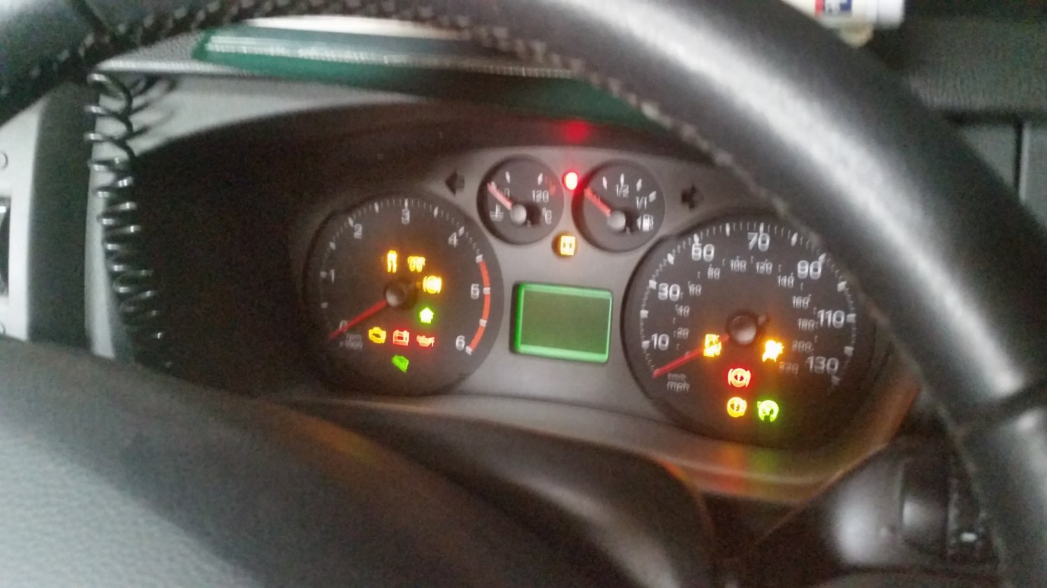

    My van has been parked up a few weeks so when I came to start it a few weekends ago it went like this..
    Turn ignition on, check gear, wait for coil light, turn key
    Swear
    Clutch down, turn key
    Swear
    Clutch down, turn key, hold for 30 seconds
    Swear
    Turn off ignition, walk up the road and collect car, drive to van, connect jump leads, run car engine, turn ignition on, wait for coil light, turn key
    Connect jump leads properly, ignition on, wait for coil light, clutch down, turn key
    Swear quite loudly
    Examine exposed fuel pipes.. No air bubbles
    Turn off all ancillary devices and listen for fuel pump - heard
    Lick up vehicle and drive to halfords for a can of cold start (swearing all the way)
    Return home and collect SWMBO
    Return to van with SWMBO and cold start
    Start van
    • Funny Funny x 12
    • Like it Like it x 2
    • Useful Useful x 1
