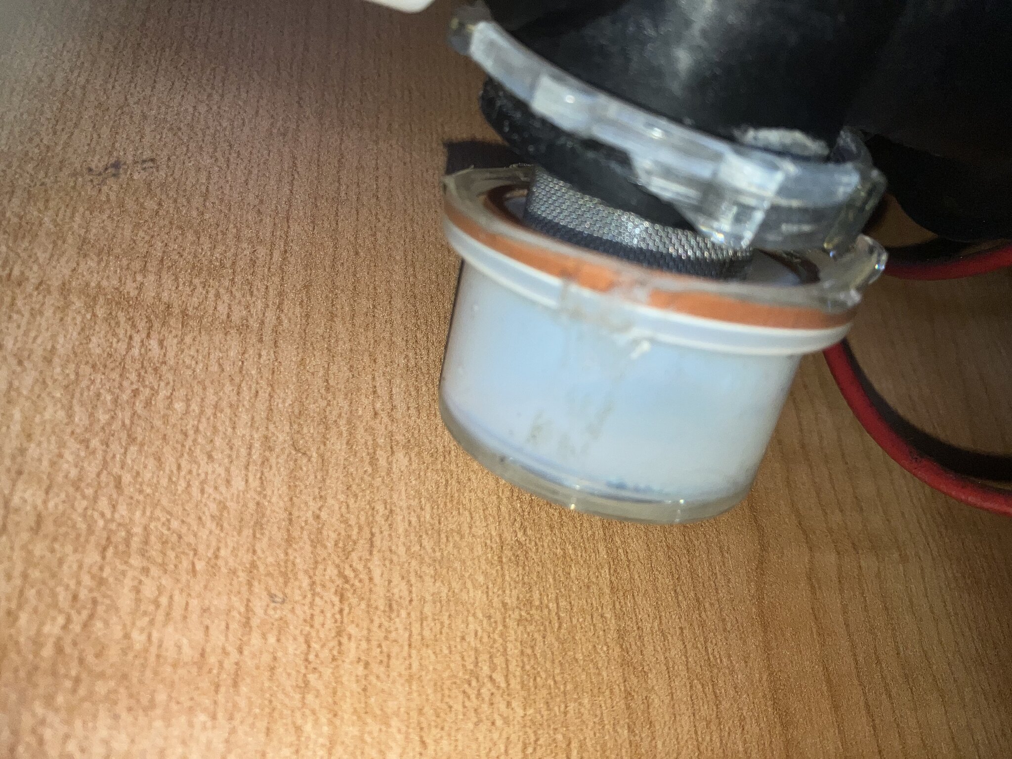

Success ! It’s under the cooker!
Now I can see the plastic cup that was identified as a possible problem and although having to lie flat on the floor to reach it, it was obviously not as it should be. It was broken in two parts.
So a replacement is required and my question is where from.. and is it so simple as just screwing back on?

Hello Phill, It will be a question of just screwing it back on, but as it says do hand tighten only, it looks like it broke due to overtightening. as to where you will find a replacement I would look for a manufacturer name and search E bay or similar to find the part.
It may have well broken due to it freezing. The water expands snapping the top off room the threads.

Yep as previously said just screw new pump filter bowl back on , fill tank with water , open taps ( hot and cold ) and turn on pump to expel air out the system . Do all taps and toilet flush . Think it’s one of these you need. 😉
When you have a new one take it off and empty it the next time you are draining the system for frost protection. Leave it off until next filling as they can fill again with residual water in the system.

The pump was under the cooker at arms length reached by lying on the floor. When we got home I found the filter housing was split allowing the pump to draw air. Before I changed the filter housing I moved the pump off the van wall and insulated it and the pipes.

Anyway, this is where things are now… I successfully purchased the replacement water filter. I actually was quite pleased with myself as I sourced the water filter locally from White Arches.
So I thought, simply screw this part on replacing the broken part and away we go.

Should the clear plastic cup holding the filter be above or below the bit it screws onto?

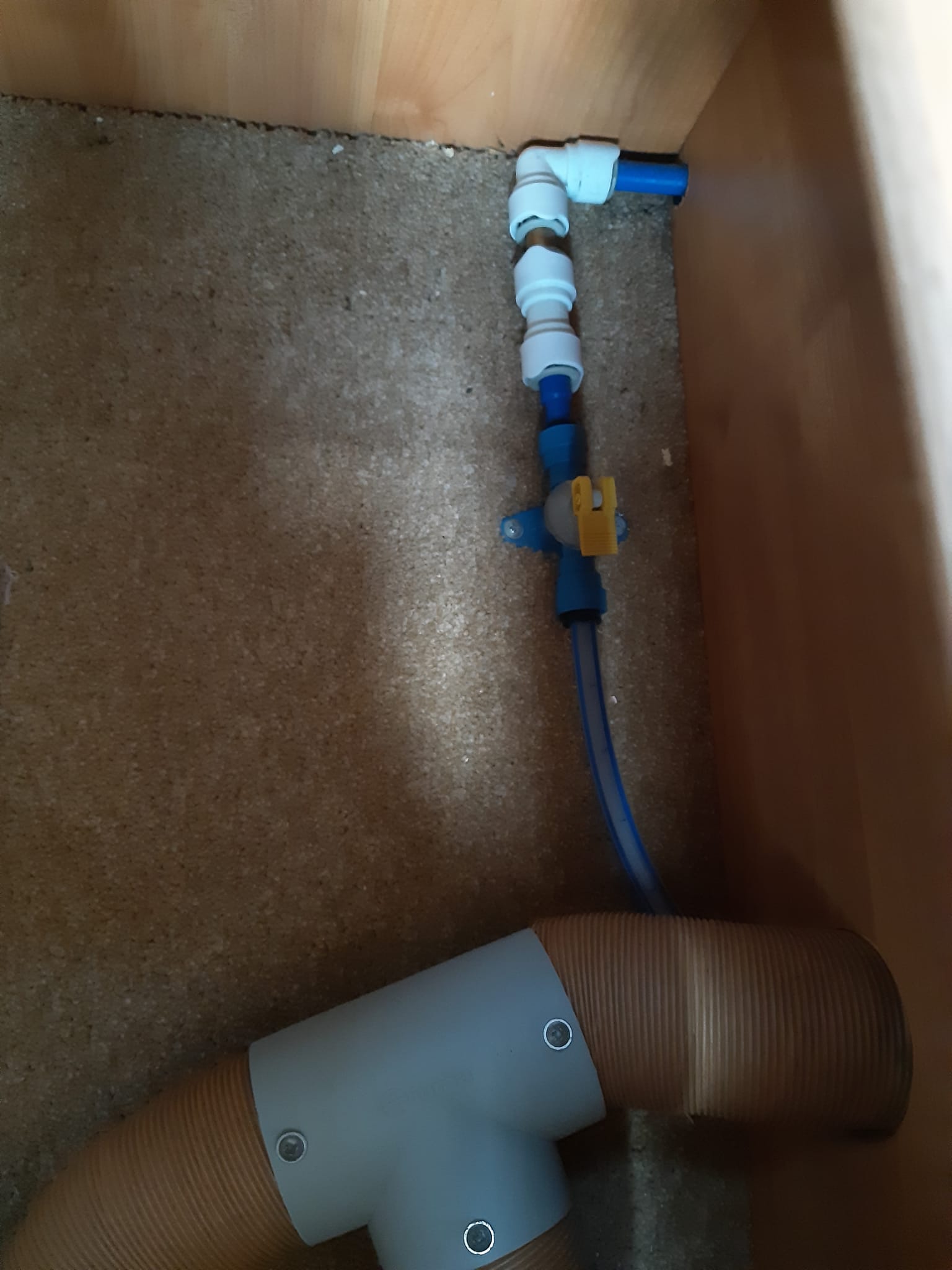

I have a couple of picture quizzes for you as well. If possible a brief explanation of what it is and what it does!
As I cannot empty the half full freshwater tank via the taps I’m assuming there must be some other method ie a separate tap directly linked to the tank?
Also what is the little yellow lever for, under the seat?

Have you forgotten the rubber seal on the filter housing?
The yellow lever is the drain valve for the system. It will drain your taps, boiler, shower etc. but you need to open all taps in the middle position to allow air back in.
That gate valve looks as though it has been fitted as a drain, so either your grey water of fresh water tank drain.
By the way the filter can be in any position.

Would the replacement part not have included the seal? It’s something to check anyway, the broken part had an orange seal within it ( see pic) maybe it needed transferring?

When the pump runs are you seeing any water come into the new filter?
If not it maybe because it is not tight enough or seal is missing, and that will allow it to just suck air instead of water.

The new part does include the seal. Checked when pump on and water appears to be in the cup thing.
Still spluttering but was more important to drain off remaining on board freshwater than get water flowing properly. Opened the lever under the seat which enabled discharge of water from pipe under van.

hi i have been told by shurflo that the filter should be on top ,, if its on top you can pour water in to the cup to bleed it ,if its air locked ,be harder if its upside down i believe,, but no doubt some on will say I'm wrong as usual ,,

I don't think it matters but most are installed with it hanging down. If is only a mesh filter to stop grit entering the pump.

I put mine as you described, simply because, when I winter drain down, it drains also. So far (6yrs on this pump), no problems. 🤞
If the cup is on top how do you undo the screws to take the cup off or is the plastic cup screwed on?
