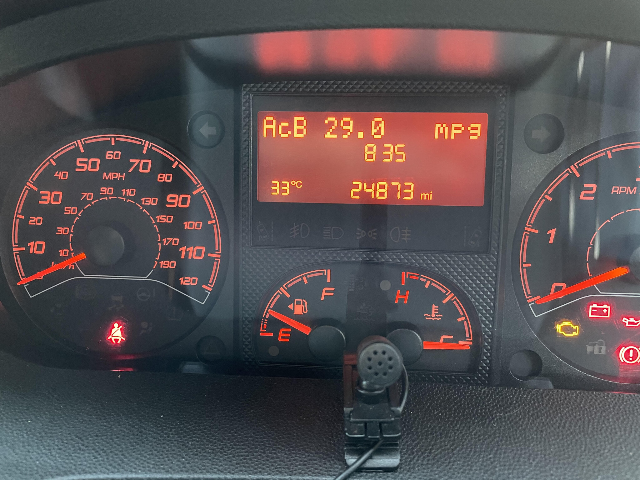

Sadly no, the air temp on or near the mirror is 19.5 about 5 minutes ago
you can see how far out it is
