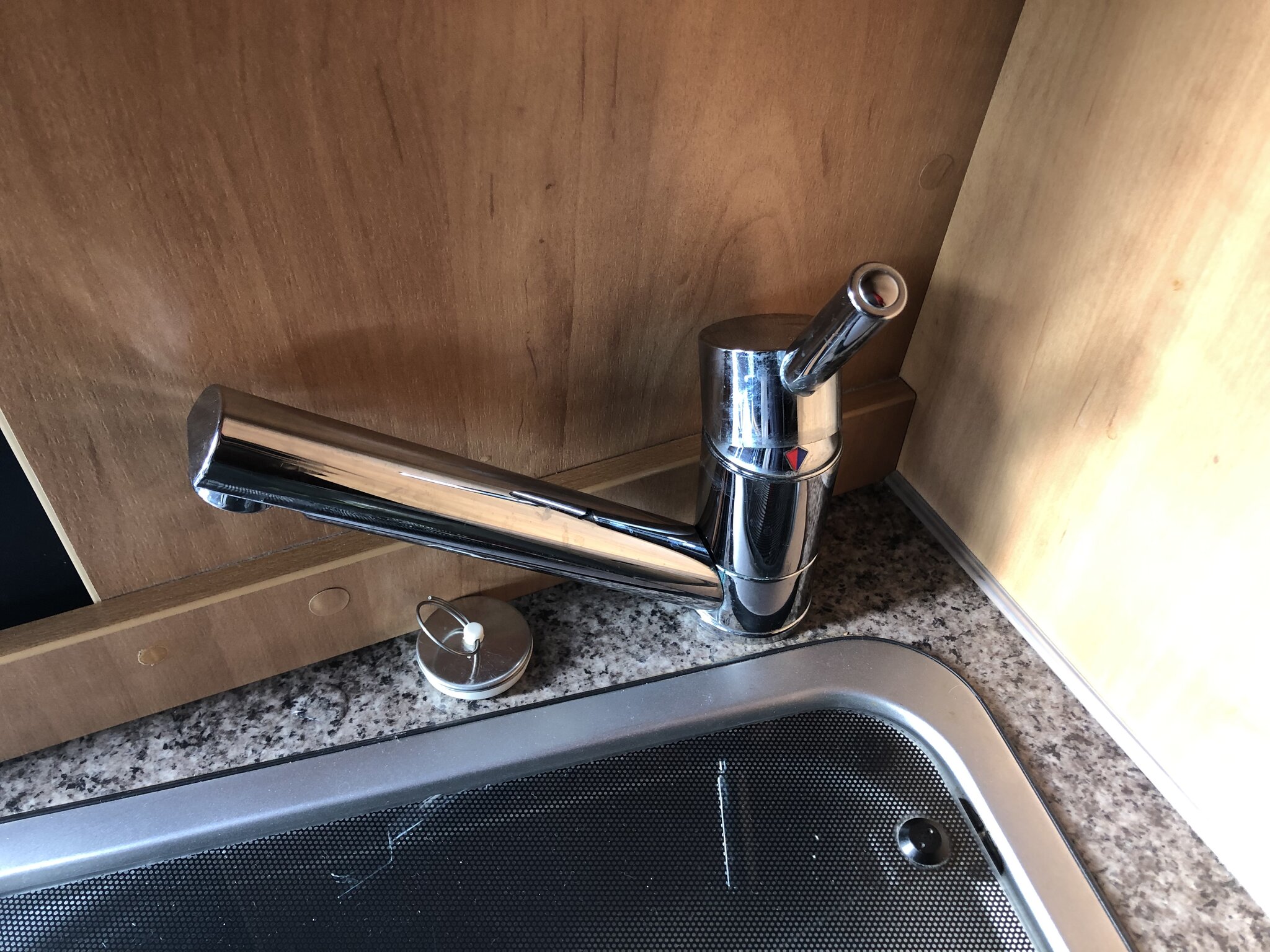

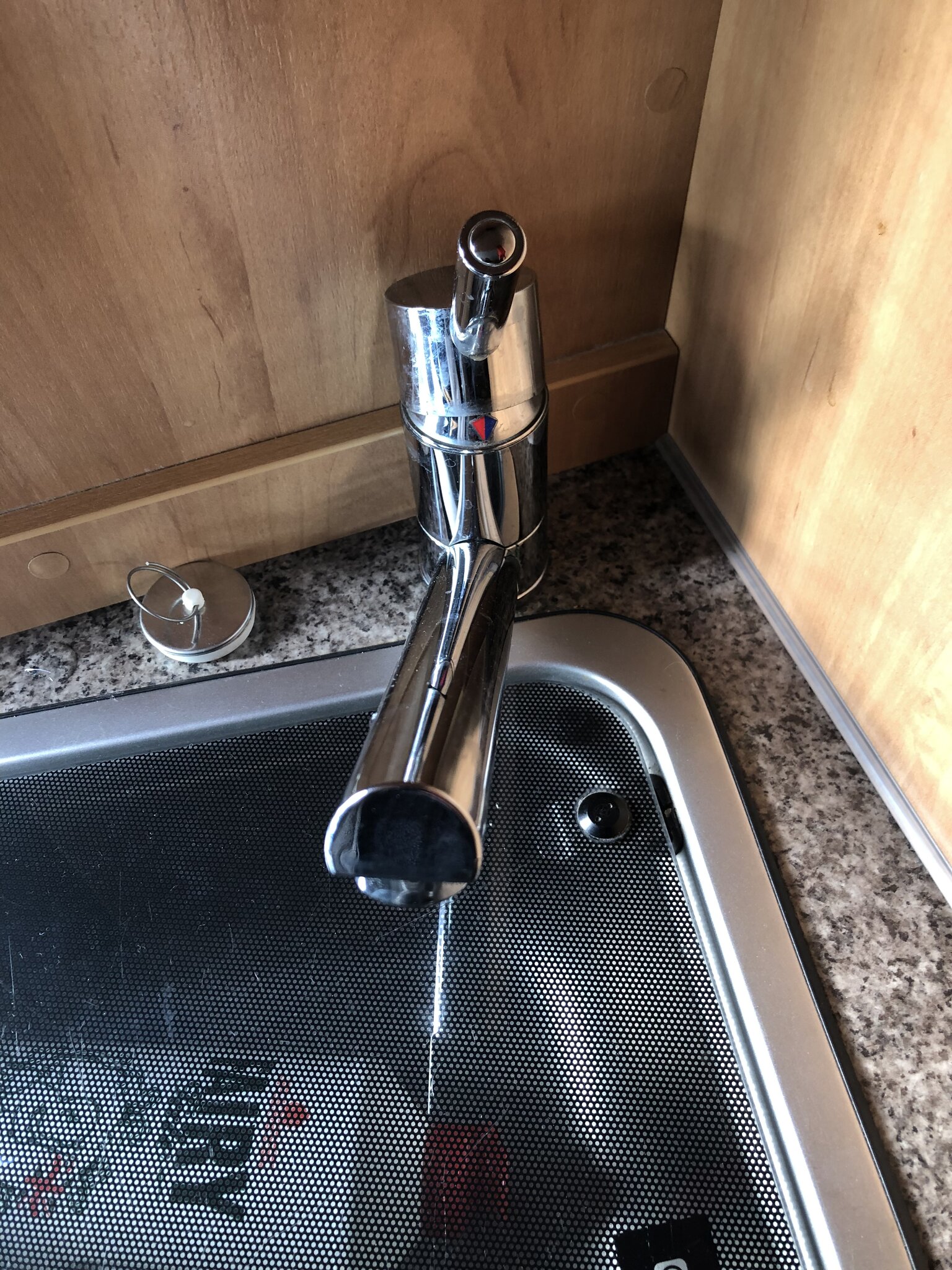

Hi I have a Possl 2win 2013 on a lhd Citroen jumper and while getting the van ready for it’s first trip out after the winter layup noticed a water leak which I have discovered is the kitchen tap.
1. Can anyone identify the tap?
2. How do I get into it to replace it?

Ah, that's a bind. I've not had to do that but from your photo it would be handy if the sink can be removed to gain access to the pipes.

We had a leak from the tap body last year which trickled down and then down via pipes. The photo below shows the tap in bits and the rubber seals which were at fault. I replaced the tap, just because I had one spare, but I think new seals would have certainly fixed it. The tap was held in place by the brass coloured nut which located the wishbone shaped piece of metal. Easy to get off with a socket or box spanner.

Remove drawers and undo large nut under the worktop surface to release tap. It's similar to a Comet Roma mixer tap. Use a heat gun on the hose connections to separate them more easily.

Your sink comes out by undoing the screws in the corners under caps. You can see them in your picture.
Full marks and kudos go to LandyAndy, got the sink out by removing the 4 screws as described!
Had to go and buy a hot air gun and will go out in a minute and heat up to loosen the barbed connections and remove the tap!

Looks like a Reich tap, the one in Manic photo is the older version the newer ones have either a blue or green plastic pin holding the connections in. They tend to leak if there is too much tension on the pipes.
