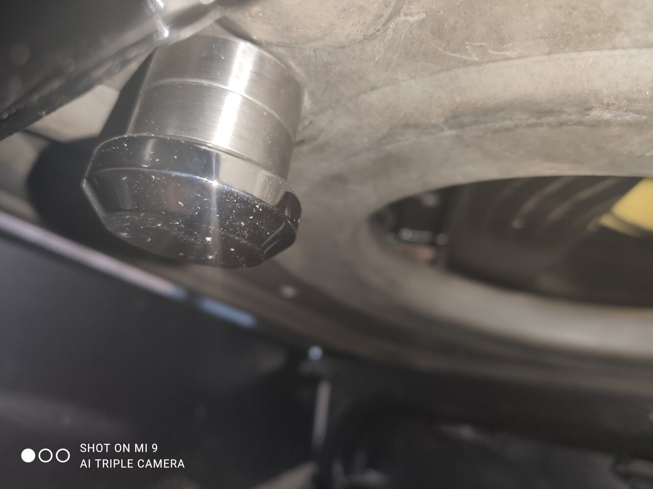

I looked at the practicalities of your statement of removing the Patriot security lock with a cordless grinder and I feel that at least in the way I have fitted mine that the removal with a cordless grinder are unfounded.
I own a Dewalt cordless grinder, the choice of most would-be thief's so offered up my grinder in many positions to try and get to the rear of the Patriot security lock to cut through the seat base plate as you suggest can be done and as you can see from the photos that this is not possible. So although you could cut up the sides of the lock, I'm happy that the rear can not be accessed.
I would just cut straight through the body of that and have it off in minutes
