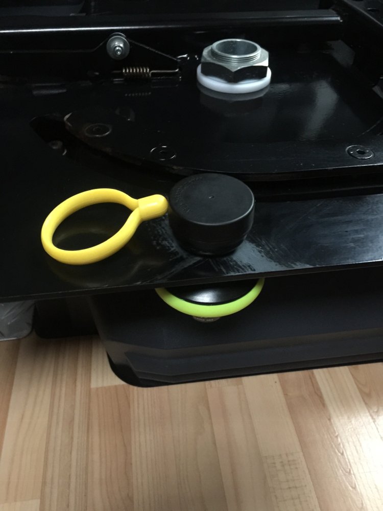

Been watching this thread for a while and decided on the patriot which seems like a good solution for my van. Having drilled a 14 mm hole it's still a tad too small. Any suggestions as best way to widen, e.g. a reamer bit, hand file or buy a 15 mm bit ? TDA.

Have a look here,
He had obviously seen it on this MotorhomeFun thread as we were already fitting the Patriot lock to our swivel seat nearly a year before he uploaded it to YouTube. :giggle:
Pity he did not take note about fitting the 6mm washer rather than faffing about with the lock mounting bracket. :doh: :giggle:

On my Ducati swivel seat there is already a loop to enable you to put a padlock through. You have to look underneath but its standard. No need to drill seat base. i just put a heavy duty longer shank padlock through to lock it backwards. Takes two minutes.
About the same amount of time to remove it with and angle grinder.

Hi I have fitted my disklok to my van and my friend said why don’t I turn my swivel seat around and drill a hole in the runner and padlock it in the turned around position so they won’t be able to sit and drive if they go to steal
It has anybody done this
Cheapest fix, drill hole through seat base the size of a 6 inch nail shaft where only you know where it is. Cut off nail head with 1 inch shaft remaining, spray nail head to match seat base. Drop through hole. Job done.
Could do that as an additional, imagine how upset they're going to be after going to all the trouble of removing the disc lock and it still won't turn 😁👍
I fitted our disc lock a bit further round than in the video so the seat is more comfortable to use, ie your legs point down onto the floor rather than onto the bench seat 👌

Hi anothet fan of oxford patriot just make sure you get the right Two different lengths of 14m/m pins
