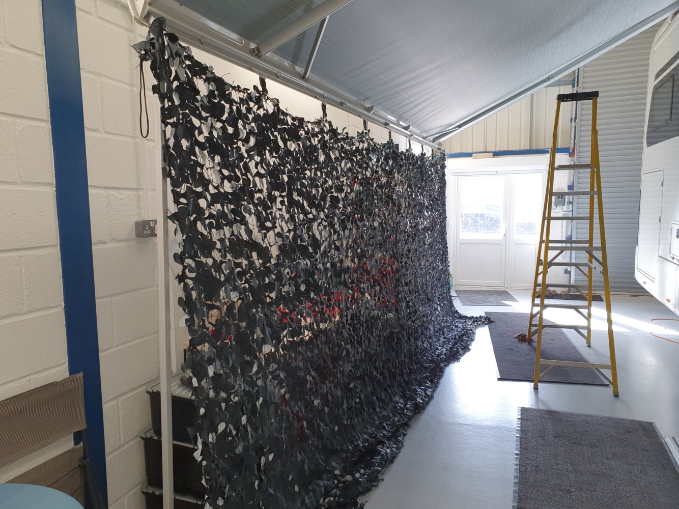

For the last 4 years we have used a Thule Sunblocker
https://www.thule.com/en-gb/motorhome-a ... m-_-307290
It has worked well but it inhibits the breeze and on some hot days it can get a bit stifling. However overall it did the job. Last year I saw a guy who had used some camouflage net with great success. It provided better shade and allowed a greater throughput of air. Before I could get to go and inspect the installation in detail he left. So this winter I found several suppliers on the web and ordered a 6m x 3m Grey/Black one.
https://www.camonets.com/product-catego ... -camo-net/
I had the local sailmaker manufacture some special clip mounts for me and today I did a first fix to see how it would work. The colours work well with the van and the individual slide on clips enable a quick release and easy install.

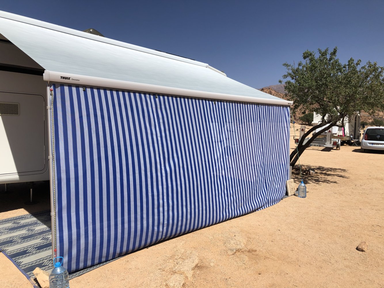

These were my efforts Michael, I got a couple of "Beach flags" from the factory for owners group meets but realised that they were far too big for a flag pole so I cut a bit off the end and then stitched a beading on the top to run it into the channel on the awning front rail.
This one is older and real quality material so doesn't let a breeze through,
This is the newer one and works really well keeping the sun off but letting a breeze through unlike the Lillypad sun blocker which got very hot behind it with no air movement.

Please zoom in on the pictures and examine my slide in clips. Because of my desire to be able to remove the net without having to move it completely by a permanently attached long slide cord I have ended up with a sort of gap at the top but cannot get my head around a better solution which still achieves the ability to easily erect and remove the screen. Any suggestions greatly appreciated.
Can you just not peg the Thule one further out instead of having it vertical?
Have and indeed do do that, and because our awning bar is quite high there is a huge gap at the bottom but it still creates an airless feel especially when the breeze is very weak. And it is not a very good sun blocker.

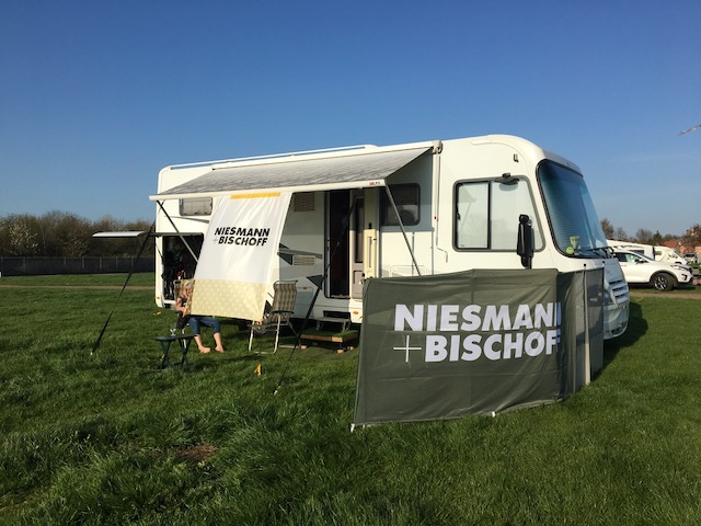

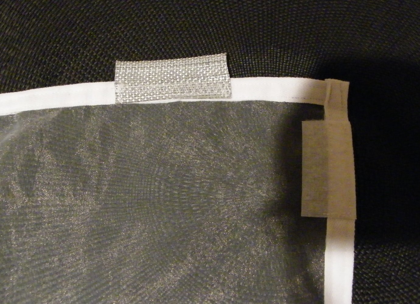

I made my own windblockers about 8 years ago to use with our MH (Chausson Flash 04). I used a large piece of voile and stitched on vertical binding tape to give strength where it was pegged at the bottom (the Lillypad ones are made from strips of material which they join so they have these vertical pieces anyway). Mine different at the top though as the LP ones have one continuous strip of beading whereas for mine I just put a 2 inch piece every now and then on the top which slotted in the awning front rail slot, this mean they could be pushed back a bit if needed to get in/out. It worked very well.

You could do what I did with my home made version by putting some pieces of beading spaced out across the top.
The issue you might have with muslin is that it could be quite stretchy so trying to stitch tape to a long length of it could be a pain in the bum ... my experience of doing it with the voile I used was bad enough and I wouldn't do it with muslin.
You could sew a deep strip of material across the top edge of the net so it is 'stiffer' and will hold the net level and fill the gap if you attach the hooks lower down the net from the top edge. Alternatively you could make a filler piece by putting some Velcro on the inner side of the awing case and use a strip of material with the other part of the Velcro on and cover the gap with it, if you do this make sure you put the grippy part of the Velcro on the casing - this would be the simplest/easiest solution and you could then also use it as a little 'sun shade' on it's own, a bit like this:
Thanks I will develop the Velcro concept I think. What I have been trying to avoid was a long strip of cord/fabric to feed into the bar. The existing Thule is a real pain requiring 2 people.

Only just fitted it whilst the van was inside its hutch, as per the pictures. I have yet to try it in "anger", a breeze of any note will have some noises anyway from nearby trees and the awning itself so I dont anticipate an issue but I will make a point to observe.

I did get the reinforced version. Reinforced Light Grey/Charcoal Camo Net. This has a string net backing, sort of like a fishing net if you will. The squares are about 4 inches or so. It provides a structure which makes it easier to hang without support. You can buy stock sizes or specify an exact size if I recall.
