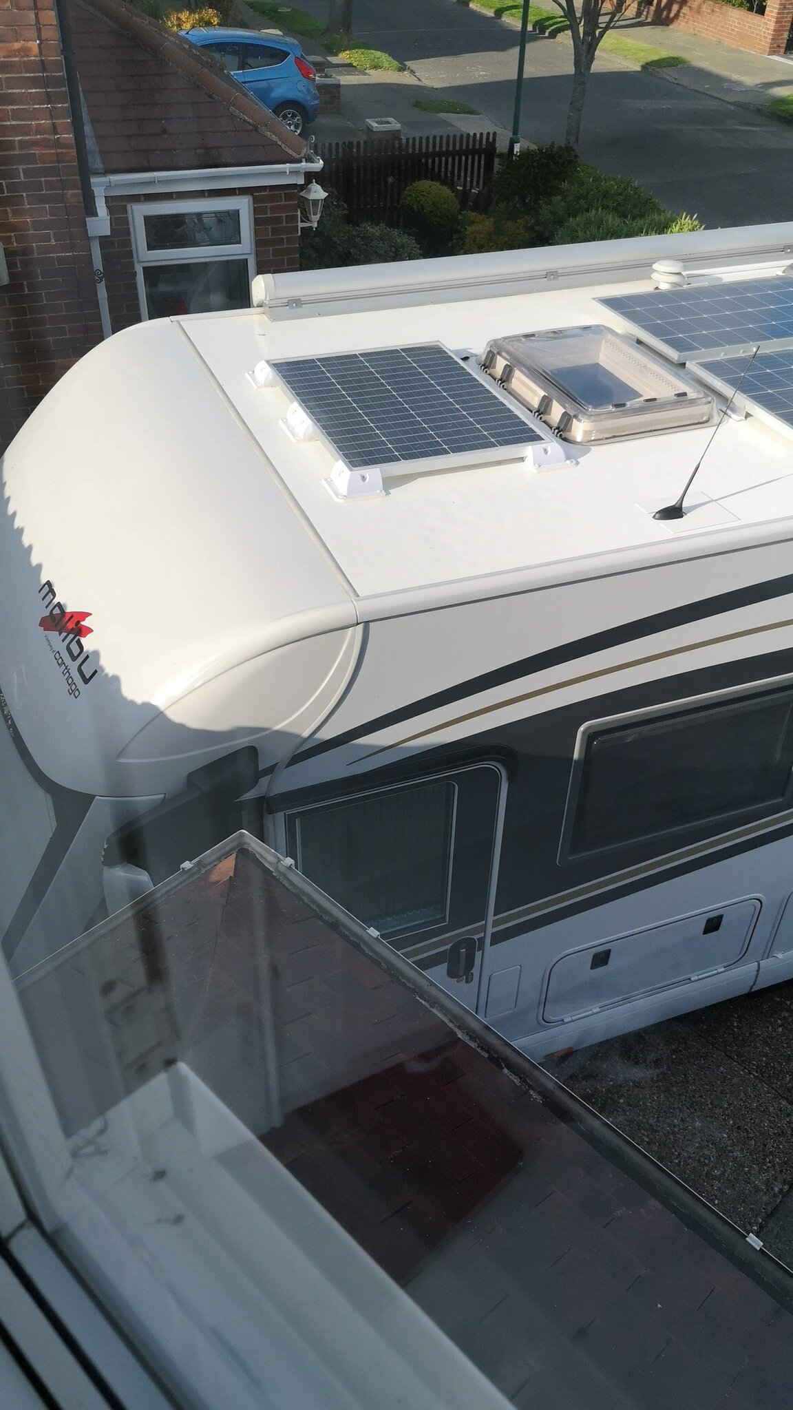

The last details I now need to consider for fitting of the solar panel involve finding the correct adhesive to fix down the supports for the solar panel. I DO NOT want to use any screw fixings into the roof of the MH at all.

I used puraflex 40 from Toolstation on western approach 👍🏻
Also give the plastic mounts a good key on the bottom I also drill some 6mm holes along the edges so the puraflex comes through then mushroom them over.
I used the above mounts with Sikaflex 522 and have had no issues. Ensure you have a 2mm bed of adhesive once the panel is in place. More adhesive is better than too little. I also used 522 to stick down a flexible panel on a previous van and no issues with that either.
Puraflex40 on my old panels with those same plastic feet - surfaces must be clean but roughed up which will vary depending on what your outer roof surface is currently. Don't mash the panel down onto the roof, 2mm thivkness of adhesive I recall was recommended. You achieve that by placing some small plastic strips into the adhesive on the feet?
Another vote for puraflex from Toolstation 👍
Was recommended to me by a fellow Funster years ago and fitted several panels on a few vans. No issues.
I ordered my panel as part of a kit I think it came with puraflex just looked they now recommend bostik 360
A tile spacer works well under the foot to maintain a bead of adhesive between the two surfaces and don’t forget to use a degresant wipe or similar to clean the roof under the feet and also the bottoms of each base
I used those white plastic ABS panel mounts with Sikaflex also, I roughed up both the underside of the brackets and the GRP roof under each bracket, placed 2p coin under each bracket to act as a spacer, marked arround each bracket position with a pencil, then masked up allowing 4mm outside the pencil lines.
Squirted the Sikaflex to each of the bracket mating faces, then some more on the van roof, placed the solar panels and pushed down evenly on all four corners, left it for 10 minutes, then removed surplus Sikaflex with a plastic scrapper, finished off with wet finger, then I peeled off the masking tape, lovely neat job.(y)

Use the correct Sikaflex depending on which roof and mounts you have or as many professionals are now using Dekasyl MS5 with the activator pack, not a cheap alternative but peace of mind is not often cheap.
I wouldn't use those plastic brackets, nearly every panel that falls of has been fixed using plastic brackets.
Far better to make or buy some aluminum brackets.
If you do use the plastic brackets you need to make sure you use the correct grade adhesive that is compatible with both surfaces both plastic & the roof material.

i use black mounts and black sikaflex but i also add two extra side brackets along the longest side.

Finally getting to talk to experts ! Turns out that Everbuild, who manufacture Puraflex40 and Sika are now one Company !
Anyway, talked to an expert at Sika about mounting the panel brackets. As mentioned in #3 Sika522 is the one the guy at Sika recommends. I had looked up the type of material that Chausson used to manufacture my vehicle, rather unhelpfully Chausson informed me that the coachwork is made of polyester and it has an anti-hail roof, but not what the roof is made of ! I do know that the main part of the roof is not GRP. I discussed with the guy from Sika what material it might be, he suggested polyester or ABS but that 522 would work just fine with either or probably any plastic which could conceivably be used.
He gave the following procedure to follow when using it.
Lightly abrase both the bottom of the ABS mounts and the area of the roof where it is to be stuck. (If using aluminium mounts, give the ali a bit more abrasion, be more wary with anodised ali.)
Wipe dust from areas.
Wipe over areas with Sika activator 205, let dry for an hour.
Apply Sika522 and assemble mounts.
