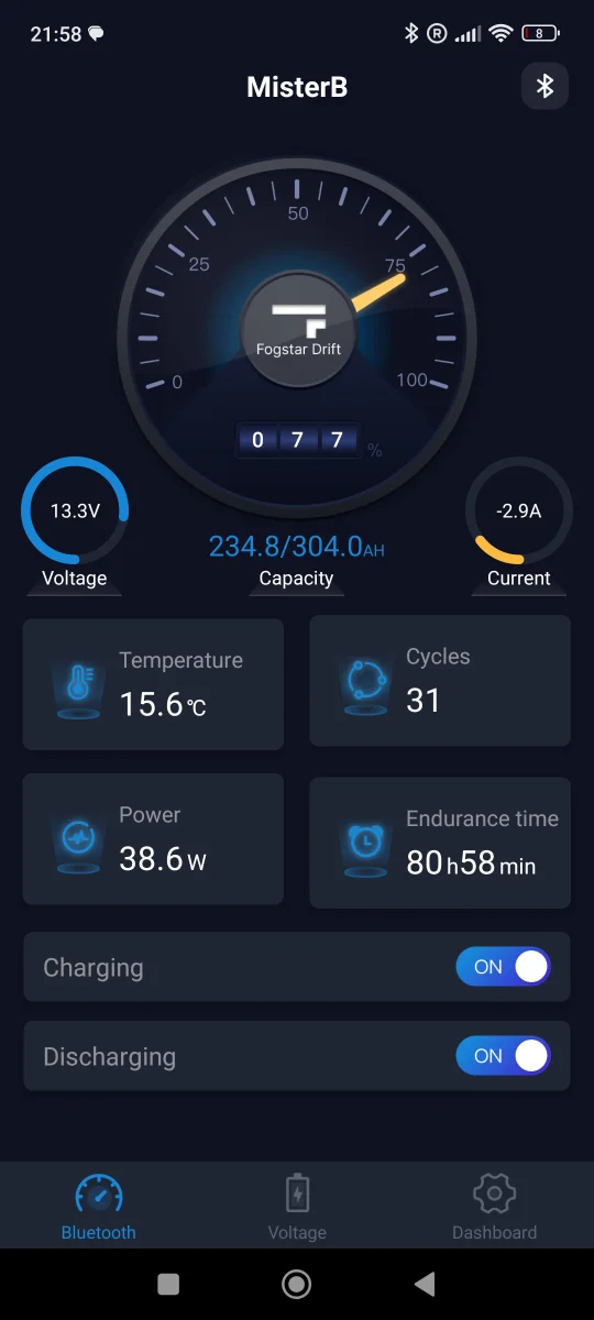

Averaging around 7 amps with the full12v conversion with integrated router board, TV and fire stick on and some lights. Will check again when I turn the TV off later
No TV - just a couple of lights in and it's down to under 3A ..... I'm more than happy with that,

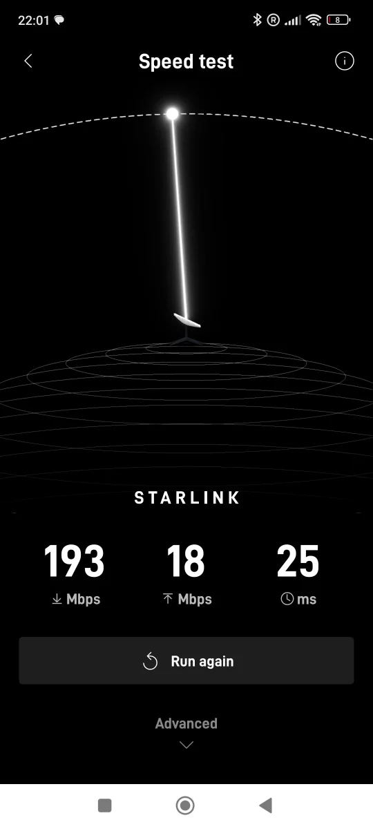

and a speed test
And with the Starlink turned off
So that means my starlink 12v with integrated router is consuming around 2.5A....

and a speed test

Good isn’t it! I get to a similar power consumption calculation with mine on 12v too… ✔️

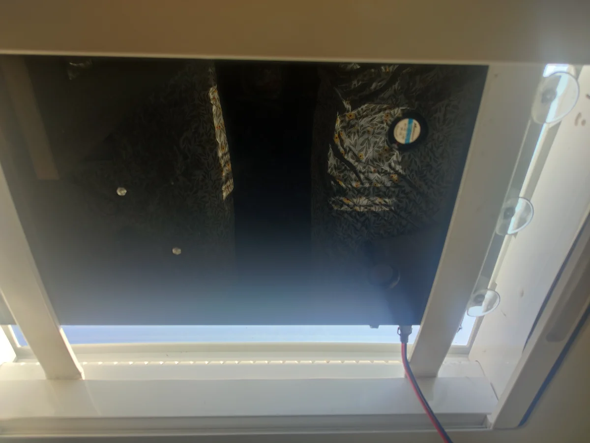

It's up against the rear roof light. You can see the small computer fans I added to keep the internal router cooled, one pulling in air, the other pushing air out, I'm not sure I needed them but the original router did get very hot, so though it can't hurt. It's a maxi mini really lol - just one 12v cable in and that's it!!

There you go, Elons got a new product if he’d contacted you for the R&D 🤪
