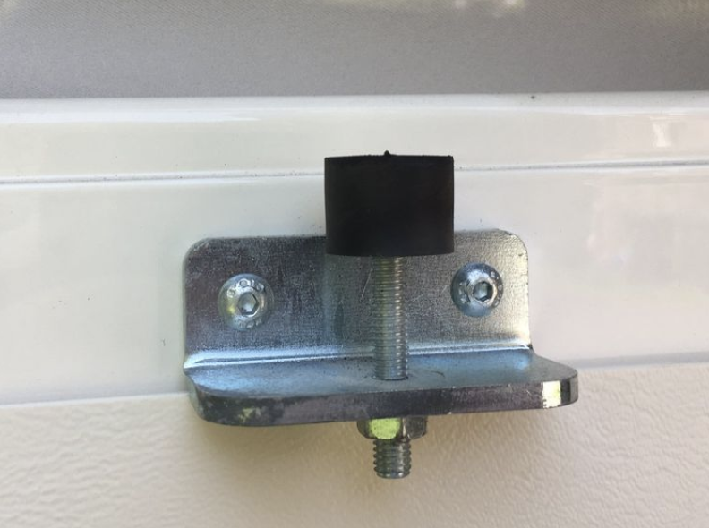

"A couple of weeks ago I asked if other dynamic line owners suffer from excessive clunking knocking and squeaking from the overcab bed when on the road as ours did despite the dealer having several attempts to cure it. Now it’s out of warranty I decided to see if I could work it all out and resolve the issue which I have done, we are now blessed with a few gentle low noise rub/ squeaks on rough surfaces so here’s my cure, I have no idea if this is the correct procedure but it’s working for us. First off I completely loosened back the forward adjusters for the bed( locknut requires a 10mm spanner) photo 1, then with the bed in stowed position both were adjusted up to touch the cantilever arm. I then dropped the bed and screwed them up a couple of turns re-stowed the bed and grasping aft end either side of release shook it up and down to see if any movement along bed front screwing them up more till movement negligible and tightened the ladjuster locknuts. Again checking bed for movement sideways this time I found there was. There are a pair of adjusters into which the spring loaded locking bar fits into. Loosening back the two Allen screws (4 mm key) Hymer have fitted 1 mm thick plastic spacers which just slot in to take up sideways play. Photo 2 & 3. Using an old dvd case which is 1.25mm thick I made up spacers (photo 4) fitting two on near side and 1 on offside checking each time for sideways movement of bed when stowed. This has completely cured the banging and creaking even on rougher roads bliss. So I hope this may give others with the same problem some ideas."

Thanks for this. I don't recognise the adjusters in photo 1. The bed certainly rocks a fair amount when its stowed, so maybe something similar is further up front hidden behind the curtain. I can see what they've done for photo 2. I'll check to see what I can do with the spacer idea...
