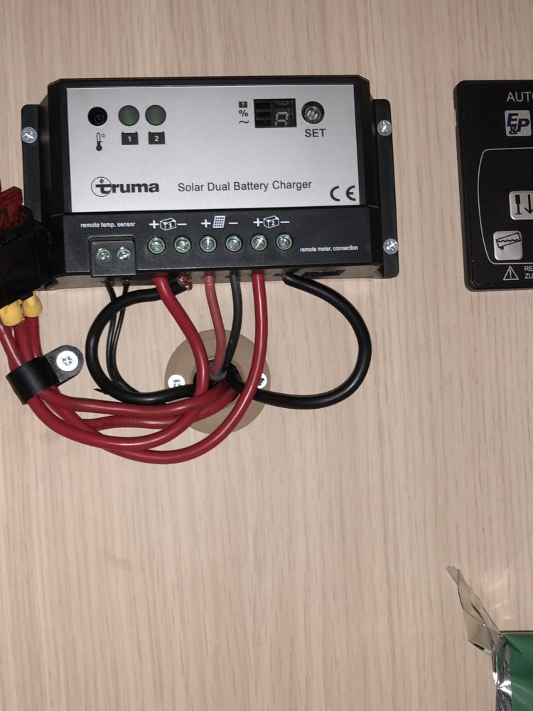

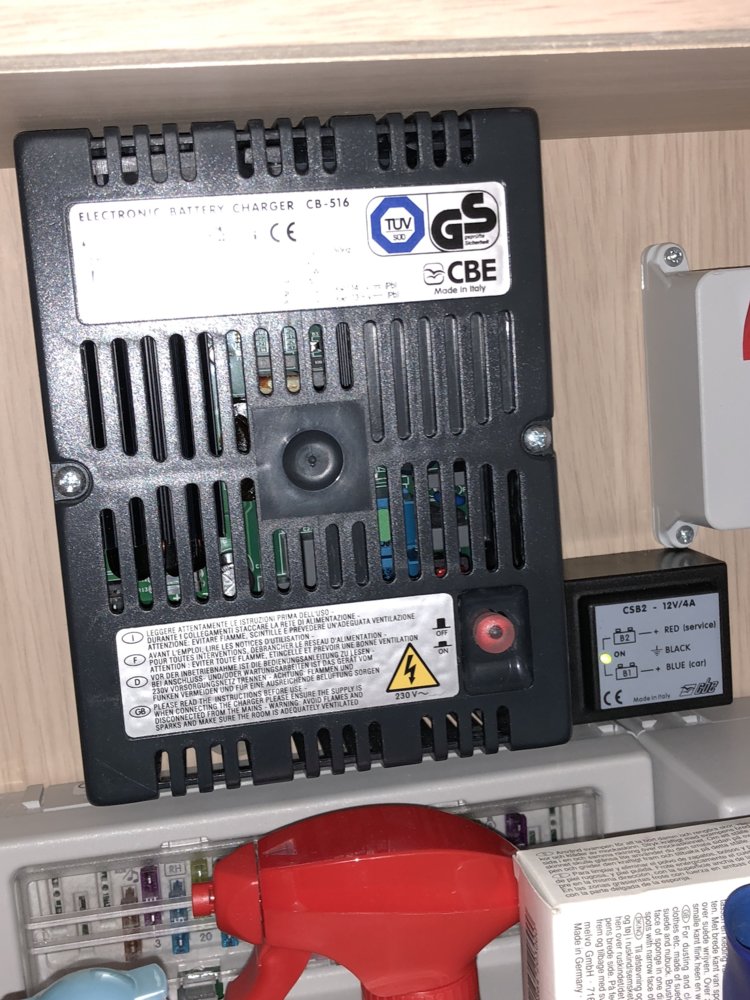

@eddievanbitz, spoke with your guys at the Nec show about upgrading my Ih to lithium, but as ever forgot to write down the advice at the time, could I check my understanding please?
My current set up is a 140amp battery, CBE 516 charger, CBE battery master, Truma 100 solar panel and regulator and a Waeco pure sine wave inverter. Cabling runs are very short as you can see in the picture.
C923C0DA-0F5F-49C2-9FFC-F385901931DF.jpeg 786E1B0B-0A1E-4531-8645-B33CD0D82A4D.jpeg EA202B76-F48C-4543-9D59-B8BBE0314D77.jpeg 811E9DB8-68AD-4CBF-8228-2FB3BFFBAFC3.jpeg
Intending to change to a 100 amp lithium for all the benefits you have mentioned before, money not the deciding factor!
Could you remind me what will need replacing please and if any of my charging equipment will be ok? Know I will need a b2b charger, I’ve a 2017 Ducato, upgraded alternator and I assume it’s a “smart” alternator.

Hi Bill,
Taking a look at the set-up I would recommend the following;
- Your Mains charger can remain "Unchanged". The charge profile can be changed to suit the Lithium we supply here.
- Your Solar Regulator will need to be changed to a more efficient MPPT type and not the PWM type you have fitted. This will not only be correct for Lithium, but an MPPT regular is a far more efficient regulator to get the maximum from your solar panels.
- A DC-DC/B2B Charger. Your vehicle will be fitted with a conventional split-charge relay system, to charge the leisure battery bank whilst your driving along. Some Hymer MLT/MLI Mercedes vehicles (just to name a couple) are fitting such devices as standard, thus doing away with the need of an additional B2B unit. Again the B2B/DC-DC not only handles the correct regime for charging Li, but you will notice the benefits from such a charger when is comes to wanting to recover the battery bank quickly (especially using the van in autumn/winter when the solar just hasn't cut the mustard in recovering any energy back to the leisure battery), compared to that of the conventional split-charge set-up. It also overcomes any issues with Euro6/Reg-gen systems fitted to newer vehicles.
