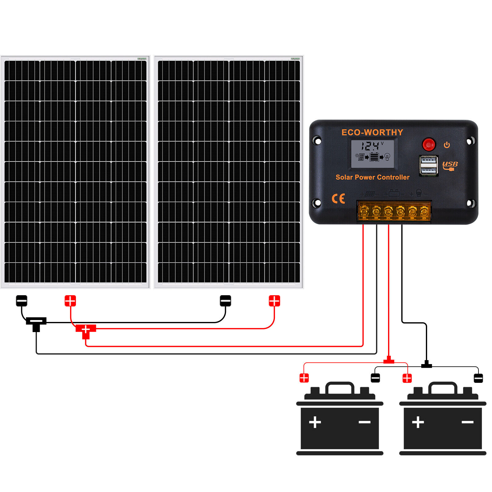

This might help
Solar kit here --- https://www.ebay.co.uk/itm/16557976...d=link&campid=5338547443&toolid=20001&mkevt=1
