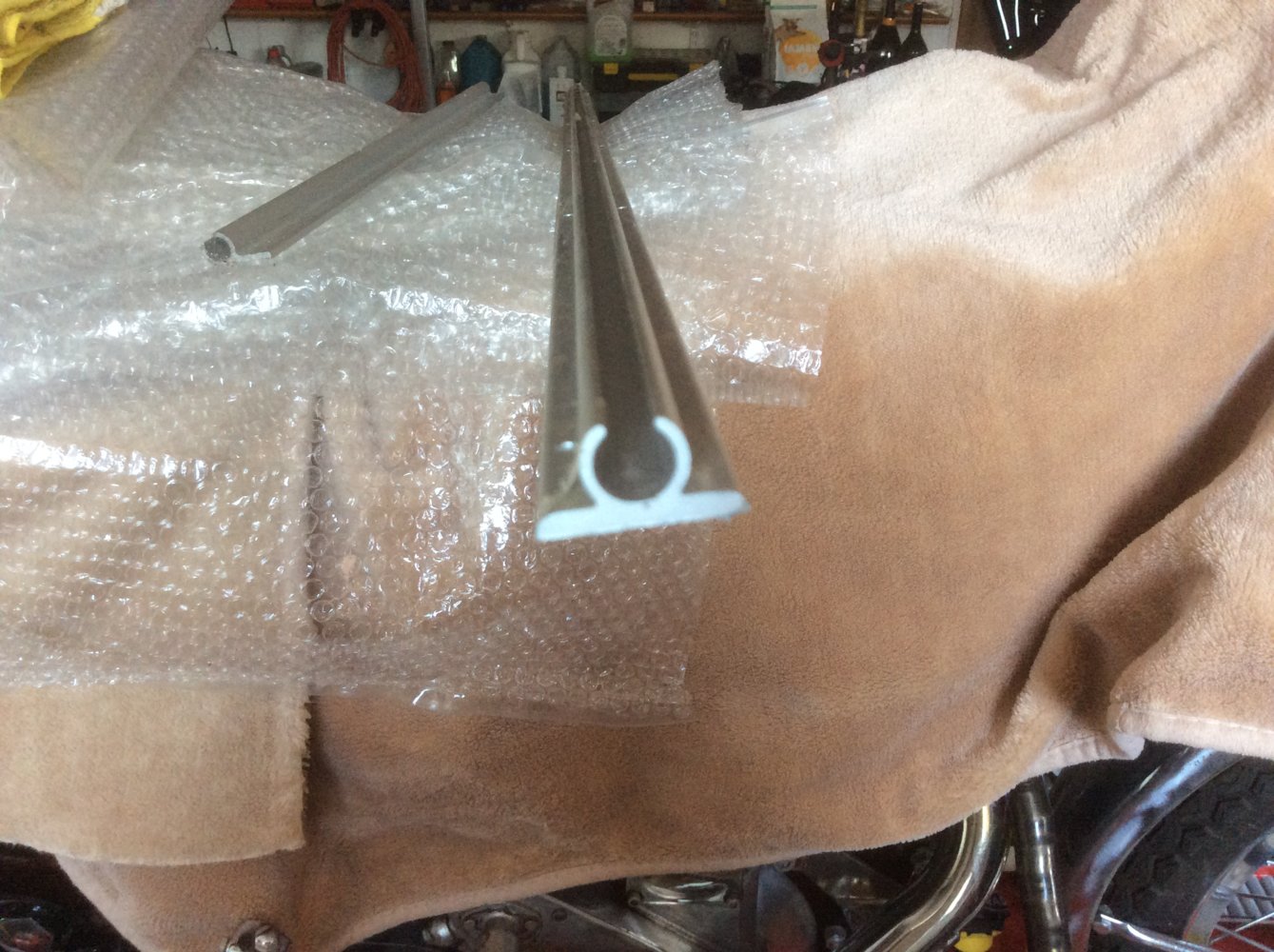

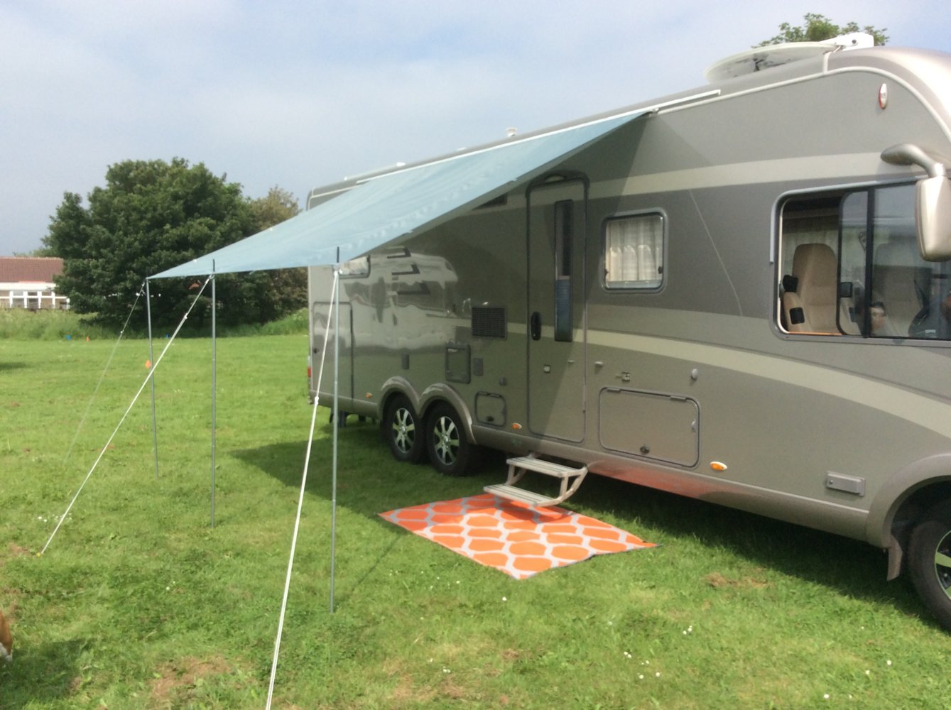

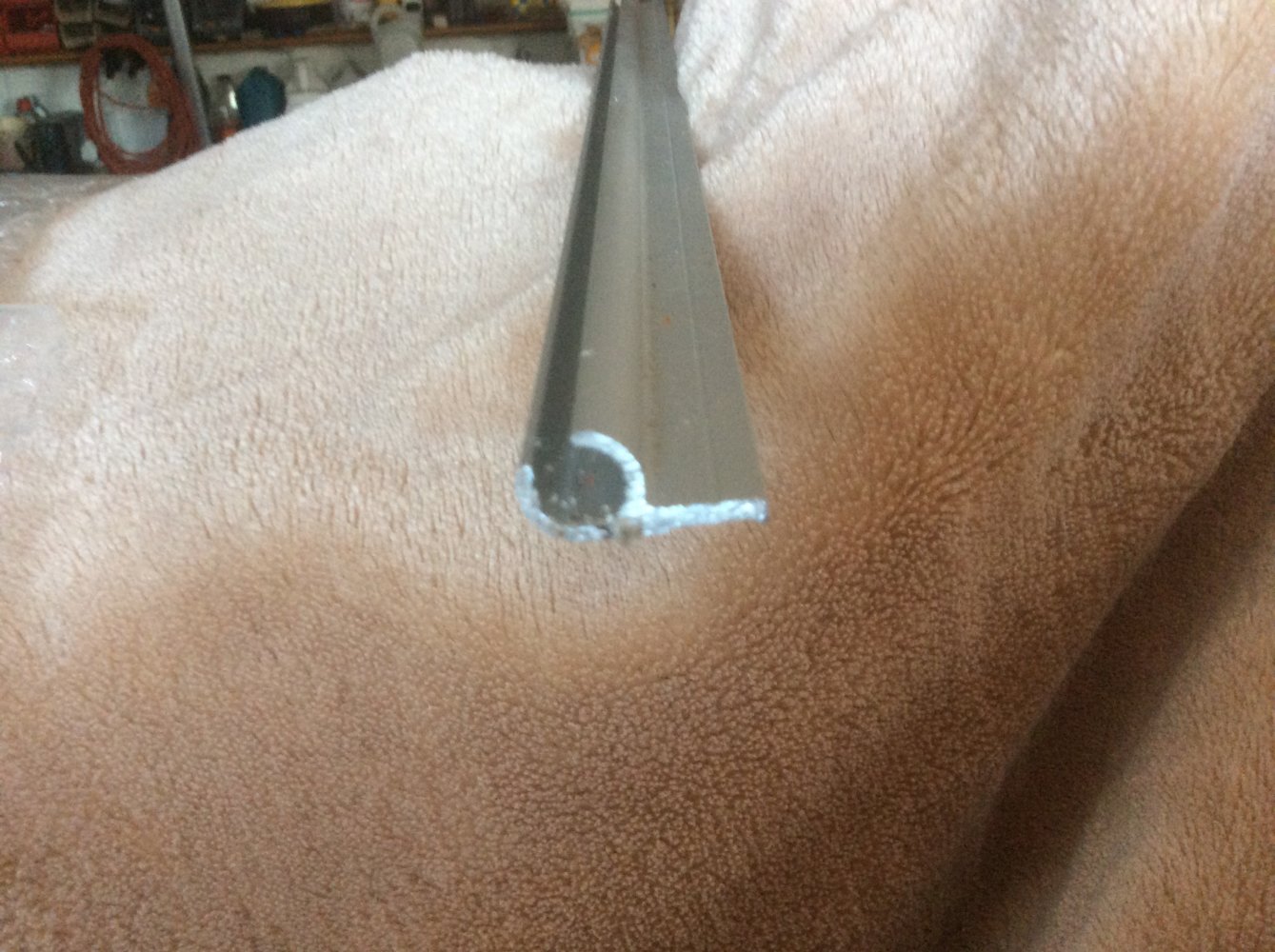

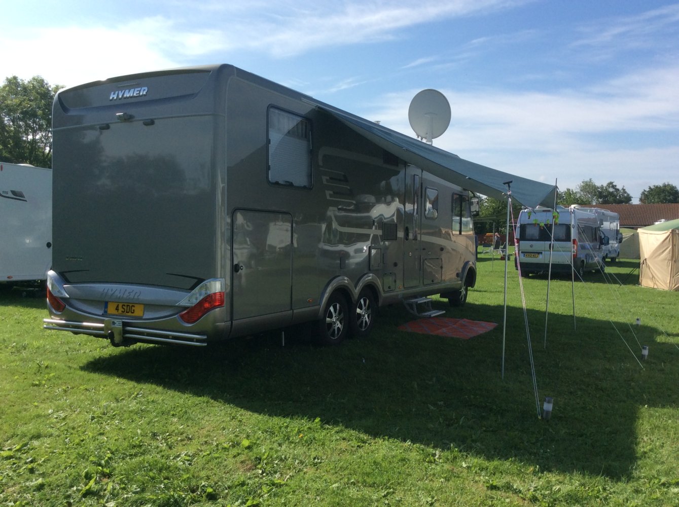

You mean like this, the one I fitted is a slightly different profile but I had to put a few small screws in to hold it as it would sag until set it is 5 mtrs Long made from two lengths.

Brilliant! thanks Steve,(y) I actually put it on hold because the only rail that I could source locally was the type where the holes have been pre-drilled through the center of the profile and so were quite rough and needed de burring at the very least. I didn't fancy putting an expensive awning through it and hung fire. That profile you used looks to be spot on and a little wider than the 12mm I was looking at. Where did you source it please.
I bought it from Pioneer Caravan’s Peterbough it comes in 3 mtr lengths
