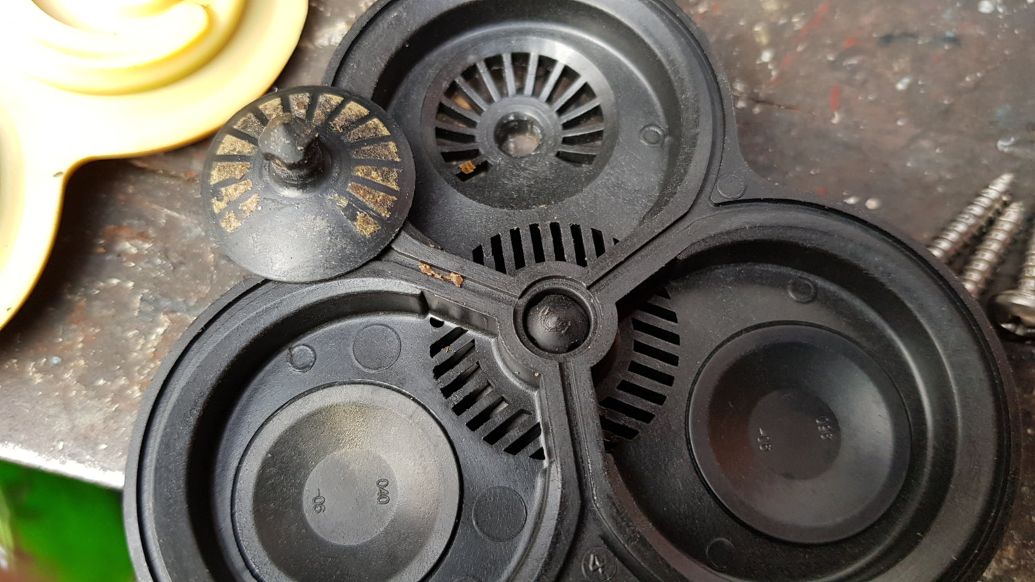

I did a thread on a pump i stripped a while ago..it had a small leak from the pump housing..which is quite a common fault.. cant find it but heres a few photos of a pump innards and the rubber valves... you will see on one of the photos you can get a build up of scale which i suppose over time could cause the pump to loose pressure via the inlet side by preventing the valve from seating properly
