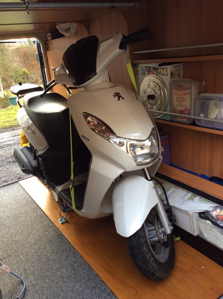

I made a plywood baseboard the exact width of the garage 500mm wide (being the exact width it cannot move) and fitted 2 tie downs (B&Q) and a wheel chock, there is an aluminium channel and sliding eyebolts along lower front wall of garage to help secure the scooter. I also use camlock straps to secure the rear wheel of the scoot onto the wheel chock. When not carrying the scoot I remove the mounting board. It is not screwed or bolted down into garage floor and has never moved in several thousand miles around Spain twice this year.

Stewart J, a Nice arrangement that, Looks solid! I will go on those lines & make a plinth for the scoot to sit on with the tie downs & wheel chock. Thanks for your help & photos appreciated!!

Hi Brian, the baseboard is made from two sheets of plywood, upper 8mm lower 3mm. Clearance holes cut on lower to accommodate bolt heads, I used 8m Roofing bolts as heads are shallower and slightly larger diameter than standard bolts, I also fitted the largest diameter washers I could find to further spread the load. Photo shows underside.
