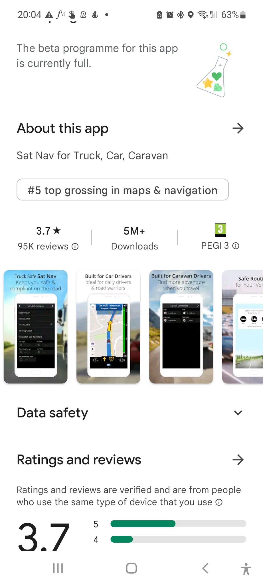

Did you actually download the RV/caravan version of the standard car version of Copilot, the two are separate versions.
I've searched for that, and believe that's what I've downloaded, it says "Sat Nav for Truck, Car, Caravan" but when I open it is for car, bike walking etc only.
Is this an Ios/Android issue?

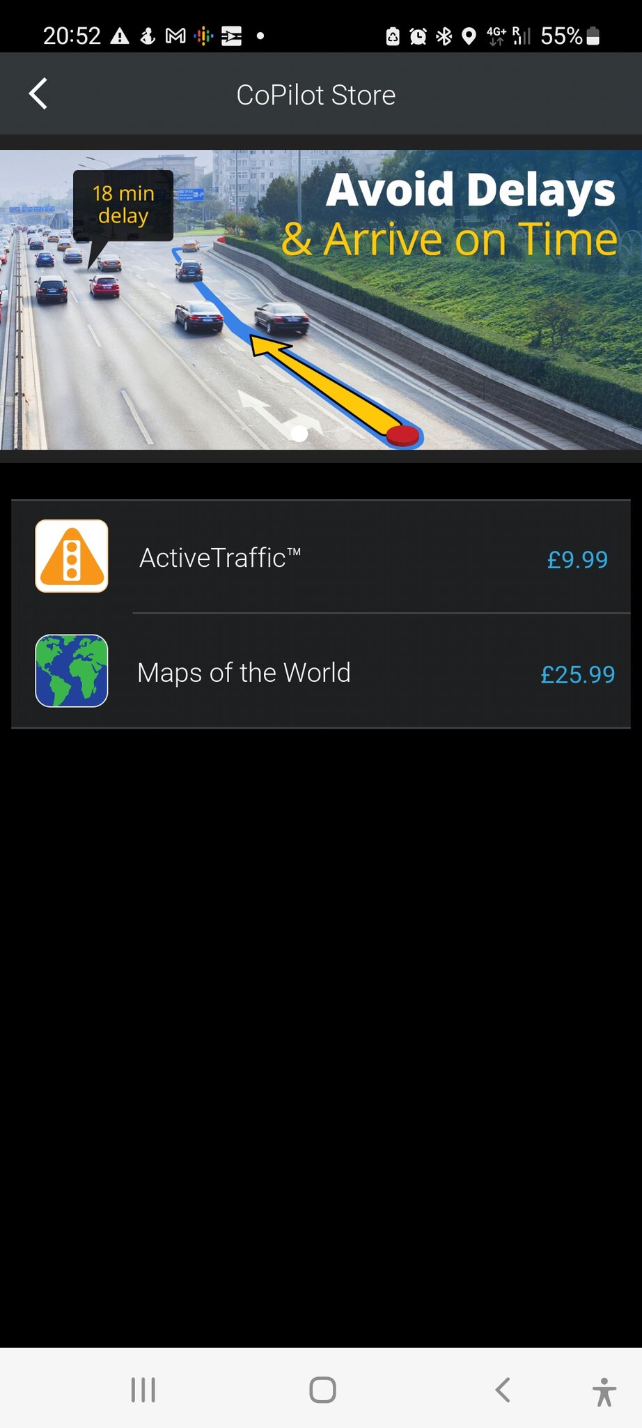

Feb 28, 2018
162
187
52,628
What options are available in the 'store' section? I've only got 'active traffic' but then I already have the caravan option.
Only active traffic and maps of the world.

funflair
Dec 11, 2013
18,893
28,980
Guisborough
29,351
MORELO palace
since 2012
I would persevere with Tom-Tom I think you should be able to just select maps for France to start with rather than the whole of Europe, I have been in your position a few years ago and di dthe download in a French supermarket.

Mar 11, 2014
930
1,292
Lincs
30,480
PVC
Since 2010
In theory the option to purchase other licences should appear there, but again on mine i don't have that option. I think mine is probably a legacy version as I purchased it years ago when it was a separate app but then they merged all the options into one (which is when I stopped using it really), but based on that there should be the option to purchase the different licences.
Only thing I can think of is to send them a support ticket.
