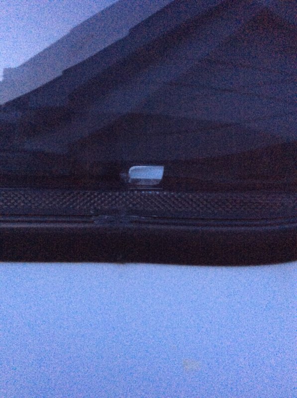

Water is getting in somehow through the rubber seal round the habitation door window. Is it an easy job to take seal out and re-seal?

Sorry Andy, van is autocruise starspirit and it is the small window on the door to the inside of van. Will try and take photo
Here are couple of photos. Water seems to be getting in along bottom of window

No def. not condensation. If I run finger along underneath of seal water runs down.
Looks like it is only collecting at the lowest point that doesn't mean that is where it is coming in.Pictures are not very good to be honest.
Is picture 2 inside or outside?
It is running down from the underneath of the seal.
Pics are not the best but simply mask up 1 or 2 mm around window and frame then seal with polyurethane sealant (toolstation £4 a tube )smooth with wet finger then pull off the tapes -eliminating it leaking from outside leaving only condensation if its wet inside

The seal looks like rubber? just put the sealant nozzle behind it
Its not going to damage the door as it is dense foam with alloy outer skin and plastic inner skin. Try get it dry (outside) pry the rubber away and inject sealant behind it.
Mask around it like Terry said and it will be less messy.
TWO person job ideally, one prying the rubber away one applying sealant

Thanks for all your help, have sorted problem by prying away seal and injecting sealant as advised above. I really appreciate your help.
