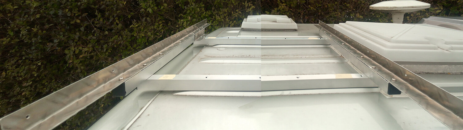

If you have space, I would make an aluminium square-section frame and mount a new rigid panel over the 'dead' one.
