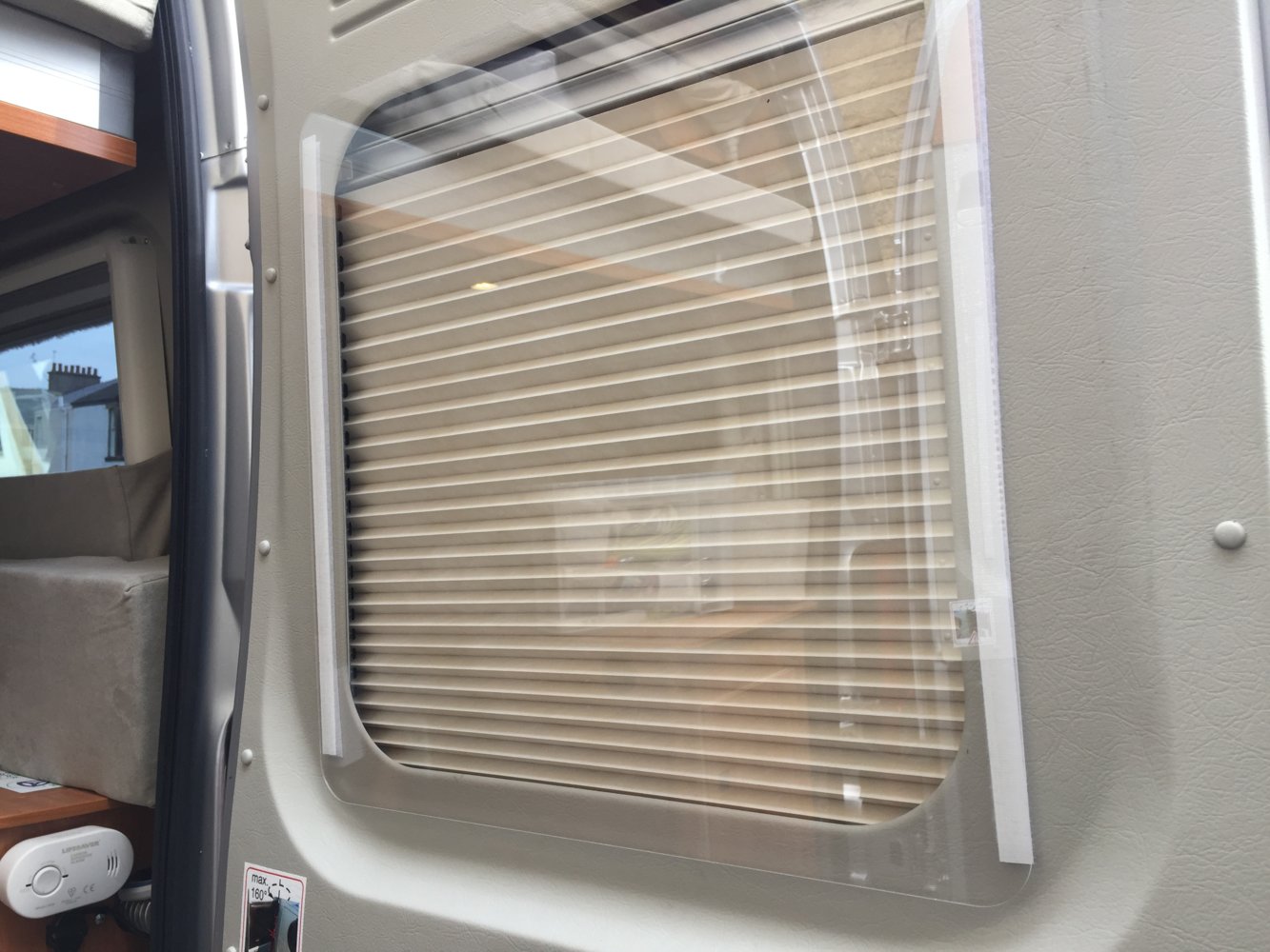

We were away for a couple of nights, so we gave the covers a good test. Sue has slept with pillows propped up on it and Ive given it a good prodding and trial opening and closing blinds and fitting and removing.
The thickness is now perfect in my opinion. It is lightweight and flexible enough to peel down from the top or bottom it allow moving the pleated blinds without full removal of the covers.

I can now supply these covers complete with strong velro strips.
The price is £50 plus post and packing for a pair for rear door windows as pictured above.
I can also have them custom made for any window.
